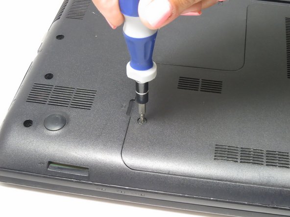

  4. Toshiba Satellite C55D-A5201 RAM Replacement, RAM: crwdns2935265:04crwdnd2935265:01crwdnd2935265:02crwdne2935265:0 Toshiba Satellite C55D-A5201 RAM Replacement, RAM: crwdns2935265:04crwdnd2935265:02crwdnd2935265:02crwdne2935265:0
    • With the Phillips #0 screwdriver, unscrew the 4.6mm screw on the left side of the "L"-shaped covering.

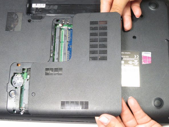

  5. Toshiba Satellite C55D-A5201 RAM Replacement: crwdns2935265:05crwdnd2935265:01crwdnd2935265:02crwdne2935265:0 Toshiba Satellite C55D-A5201 RAM Replacement: crwdns2935265:05crwdnd2935265:02crwdnd2935265:02crwdne2935265:0
    • Lift up the "L"-shaped plastic covering to remove it.
