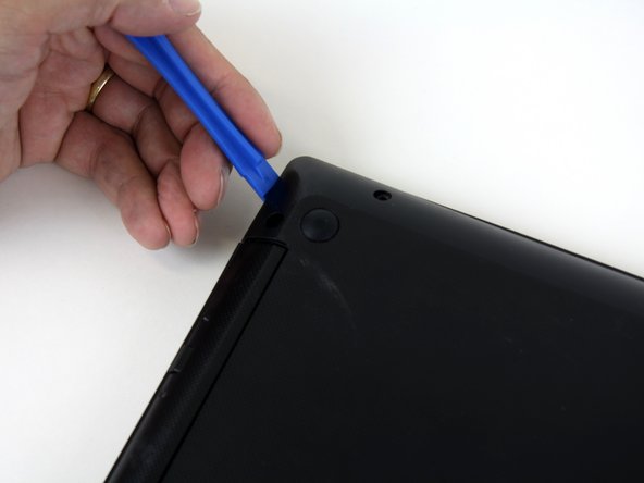

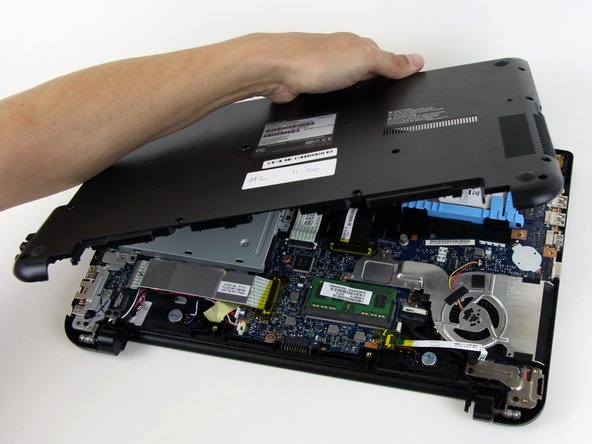

  4. Toshiba Satellite C55-B5302 laptop Memory chip (RAM)  Replacement, Memory chip (RAM): crwdns2935265:04crwdnd2935265:01crwdnd2935265:03crwdne2935265:0 Toshiba Satellite C55-B5302 laptop Memory chip (RAM)  Replacement, Memory chip (RAM): crwdns2935265:04crwdnd2935265:02crwdnd2935265:03crwdne2935265:0 Toshiba Satellite C55-B5302 laptop Memory chip (RAM)  Replacement, Memory chip (RAM): crwdns2935265:04crwdnd2935265:03crwdnd2935265:03crwdne2935265:0
    • Remove the remaining thirteen 7 mm screws on the back panel of the laptop with a Phillips #0 screwdriver.
    • Use the plastic opening tool to pry up a corner of the back panel and continue to pop the back panel off.
    • Expect to hear popping as you pull the back panel off.
  5. Toshiba Satellite C55-B5302 laptop Memory chip (RAM)  Replacement: crwdns2935265:05crwdnd2935265:01crwdnd2935265:03crwdne2935265:0 Toshiba Satellite C55-B5302 laptop Memory chip (RAM)  Replacement: crwdns2935265:05crwdnd2935265:02crwdnd2935265:03crwdne2935265:0 Toshiba Satellite C55-B5302 laptop Memory chip (RAM)  Replacement: crwdns2935265:05crwdnd2935265:03crwdnd2935265:03crwdne2935265:0
    • Push down on the two clips holding the RAM chip in place.
    • Pull the RAM chip up slightly and out away from the connection to remove.
