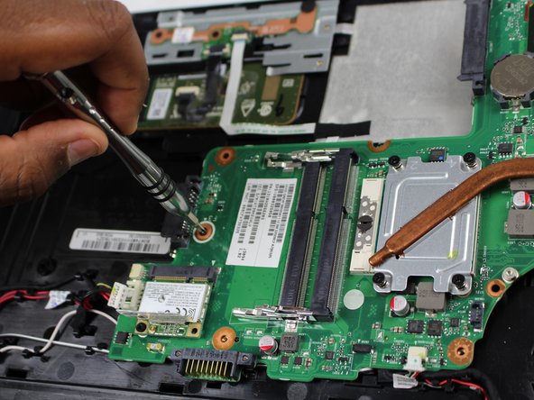

  8. Toshiba Satellite C55-A5310 Fan Replacement: crwdns2935265:08crwdnd2935265:01crwdnd2935265:02crwdne2935265:0 Toshiba Satellite C55-A5310 Fan Replacement: crwdns2935265:08crwdnd2935265:02crwdnd2935265:02crwdne2935265:0
    • Remove the single .5mm JIS #000 screw.

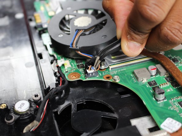

  14. Toshiba Satellite C55-A5310 Fan Replacement: crwdns2935265:014crwdnd2935265:01crwdnd2935265:03crwdne2935265:0 Toshiba Satellite C55-A5310 Fan Replacement: crwdns2935265:014crwdnd2935265:02crwdnd2935265:03crwdne2935265:0 Toshiba Satellite C55-A5310 Fan Replacement: crwdns2935265:014crwdnd2935265:03crwdnd2935265:03crwdne2935265:0
    • Remove the four wires with tweezers.
    • Remove wires gently to avoid damaging them.
  15. Toshiba Satellite C55-A5310 Fan Replacement: crwdns2935265:015crwdnd2935265:01crwdnd2935265:01crwdne2935265:0
    • Lift from corresponding sides of the fan and it'll pop right out.
