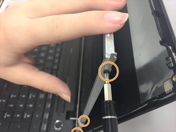

  7. Toshiba Satellite C55-A5302 Screen Replacement: crwdns2935265:07crwdnd2935265:01crwdnd2935265:02crwdne2935265:0 Toshiba Satellite C55-A5302 Screen Replacement: crwdns2935265:07crwdnd2935265:02crwdnd2935265:02crwdne2935265:0
    • Remove the two screws in the top corners with a Phillips #1 screwdriver. The screen will pop forward after removing the two screws.
    • Using the same Phillips #1 screwdriver, remove the three screws on the side of screen frame.
  8. Toshiba Satellite C55-A5302 Screen Replacement: crwdns2935265:08crwdnd2935265:01crwdnd2935265:02crwdne2935265:0 Toshiba Satellite C55-A5302 Screen Replacement: crwdns2935265:08crwdnd2935265:02crwdnd2935265:02crwdne2935265:0
    • On the back of screen, lift up the plastic film and screen connector. Pop out the connector, and gently remove the screen.
