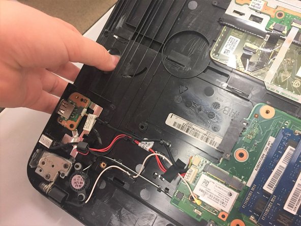

  11. Toshiba Satellite C55-A5302 Keyboard Replacement: crwdns2935265:011crwdnd2935265:01crwdnd2935265:02crwdne2935265:0 Toshiba Satellite C55-A5302 Keyboard Replacement: crwdns2935265:011crwdnd2935265:02crwdnd2935265:02crwdne2935265:0
    • Grab hold of the optical drive and elevate it slightly and remove it from the computer.
  12. Toshiba Satellite C55-A5302 Keyboard Replacement, Keyboard: crwdns2935265:012crwdnd2935265:01crwdnd2935265:02crwdne2935265:0 Toshiba Satellite C55-A5302 Keyboard Replacement, Keyboard: crwdns2935265:012crwdnd2935265:02crwdnd2935265:02crwdne2935265:0
    • Using your thumb, apply a light amount of pressure to the underside of the keyboard until it pops out a bit.
  13. Toshiba Satellite C55-A5302 Keyboard Replacement: crwdns2935265:013crwdnd2935265:01crwdnd2935265:01crwdne2935265:0
    • Using the metal spudger, carefully pry up the edges of the keyboard.
  14. Toshiba Satellite C55-A5302 Keyboard Replacement: crwdns2935265:014crwdnd2935265:01crwdnd2935265:01crwdne2935265:0
    • Shift the small tabs on either side of the ribbon outwards to release the end of the ribbon.
    • Gently remove the keyboard from the device.
