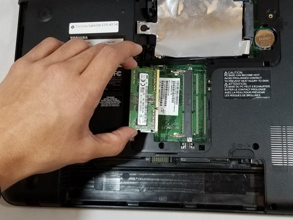

    • Make sure that the device is unplugged, completely off, and that the device is not warm to the touch.
    • Flip the device over, and unscrew the 5mm PH#1 screw on L shaped access panel.
    • Screw will not come out of access panel: simply unscrew until loose.
  2. Toshiba Satellite C55-A5140 RAM Replacement: crwdns2935265:02crwdnd2935265:01crwdnd2935265:01crwdne2935265:0
    • Use the plastic opening tool to open access panel by sliding it into notch near screw and prying access panel(L-shaped) away from device.
    • Pull panel completely free from device and set aside.
  3. Toshiba Satellite C55-A5140 RAM Replacement: crwdns2935265:03crwdnd2935265:01crwdnd2935265:02crwdne2935265:0 Toshiba Satellite C55-A5140 RAM Replacement: crwdns2935265:03crwdnd2935265:02crwdnd2935265:02crwdne2935265:0
    • Push the two metal tabs on each side of RAM stick outward (away from RAM) to unlock from tray.
    • Pull ram straight out (away from connector) to remove.
To reassemble your device, follow these instructions in reverse order. After sliding new RAM into tray, push straight downward to lock it into position.
