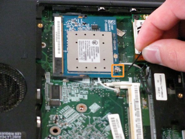

  7. Toshiba Satellite A85-S107 15" Wireless Card Replacement, Wireless Card: crwdns2935265:07crwdnd2935265:01crwdnd2935265:02crwdne2935265:0 Toshiba Satellite A85-S107 15" Wireless Card Replacement, Wireless Card: crwdns2935265:07crwdnd2935265:02crwdnd2935265:02crwdne2935265:0
    • Carefully pull the white auxiliary wire out of its socket on the wireless card.
    • Now repeat this step with the black auxiliary wire.
    • Be careful when removing the wires, as the wireless card and the wires are delicate.
  8. Toshiba Satellite A85-S107 15" Wireless Card Replacement: crwdns2935265:08crwdnd2935265:01crwdnd2935265:02crwdne2935265:0 Toshiba Satellite A85-S107 15" Wireless Card Replacement: crwdns2935265:08crwdnd2935265:02crwdnd2935265:02crwdne2935265:0
    • Push the two black tabs, located on the sides of the card, away from the card.
    • The right side of the wireless card should now pop out of its holder.
    • Pull the wireless card out by lifting it from the dock and sliding it towards the right.
