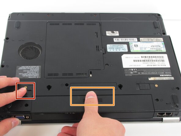

    • Power off the laptop.
    • Disconnect the power cable from the laptop. If you do not, electric shock may result.
  2. Toshiba Satellite A85-S107 15" Fan Replacement: crwdns2935265:02crwdnd2935265:01crwdnd2935265:01crwdne2935265:0
    • Flip the laptop over and orient it such that the battery faces towards you and the front faces away from you as shown in the diagram.
    • Unlock the battery by sliding the tab shown to the right
    • This tab will latch into place.
  3. Toshiba Satellite A85-S107 15" Fan Replacement: crwdns2935265:03crwdnd2935265:01crwdnd2935265:02crwdne2935265:0 Toshiba Satellite A85-S107 15" Fan Replacement: crwdns2935265:03crwdnd2935265:02crwdnd2935265:02crwdne2935265:0
    • Slide the tab shown to the left and remain holding it.
    • This tab does not lock into place like in the first step.
    • Place your thumb on the grips of the battery as shown.
    • While holding onto the grips, pull the battery towards you and away from the laptop.

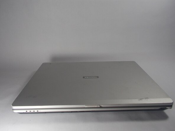

  4. Toshiba Satellite A85-S107 15" Fan Replacement, Keyboard: crwdns2935265:04crwdnd2935265:01crwdnd2935265:01crwdne2935265:0
    • Flip the laptop over so that the front tab of the laptop faces you.
  5. Toshiba Satellite A85-S107 15" Fan Replacement: crwdns2935265:05crwdnd2935265:01crwdnd2935265:03crwdne2935265:0 Toshiba Satellite A85-S107 15" Fan Replacement: crwdns2935265:05crwdnd2935265:02crwdnd2935265:03crwdne2935265:0 Toshiba Satellite A85-S107 15" Fan Replacement: crwdns2935265:05crwdnd2935265:03crwdnd2935265:03crwdne2935265:0
    • Unlock the laptop by sliding the front tab to the right.
    • Open the laptop by lifting the screen up while holding the tab in place.
