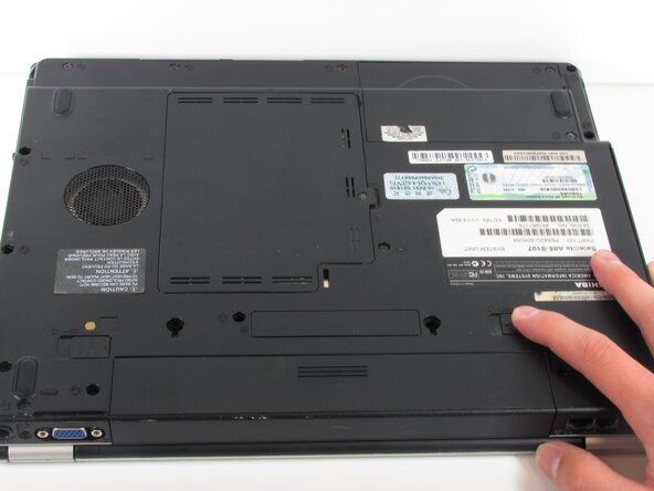

  3. Toshiba Satellite A85-S107 15" Disc Drive Replacement: crwdns2935265:03crwdnd2935265:01crwdnd2935265:02crwdne2935265:0 Toshiba Satellite A85-S107 15" Disc Drive Replacement: crwdns2935265:03crwdnd2935265:02crwdnd2935265:02crwdne2935265:0
    • Slide the tab shown to the left and remain holding it.
    • This tab does not lock into place like in the first step.
    • Place your thumb on the grips of the battery as shown.
    • While holding onto the grips, pull the battery towards you and away from the laptop.

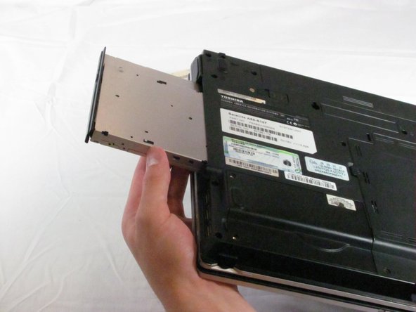

  4. Toshiba Satellite A85-S107 15" Disc Drive Replacement, Disc Drive: crwdns2935265:04crwdnd2935265:01crwdnd2935265:02crwdne2935265:0 Toshiba Satellite A85-S107 15" Disc Drive Replacement, Disc Drive: crwdns2935265:04crwdnd2935265:02crwdnd2935265:02crwdne2935265:0
    • Flip the laptop over and orient it so that the battery faces away from you.
    • Remove the 5mm Phillips #0 screw on the bottom case.

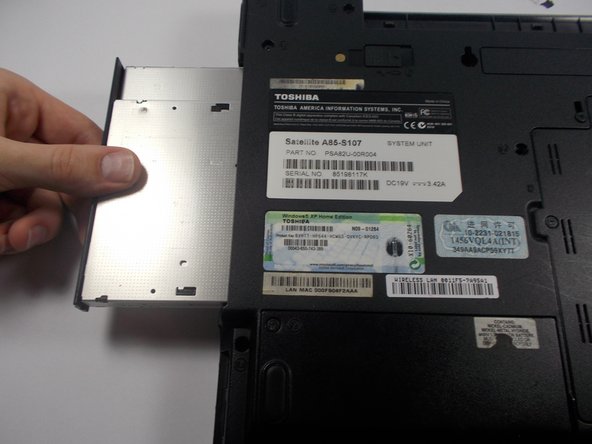

  5. Toshiba Satellite A85-S107 15" Disc Drive Replacement: crwdns2935265:05crwdnd2935265:01crwdnd2935265:03crwdne2935265:0 Toshiba Satellite A85-S107 15" Disc Drive Replacement: crwdns2935265:05crwdnd2935265:02crwdnd2935265:03crwdne2935265:0 Toshiba Satellite A85-S107 15" Disc Drive Replacement: crwdns2935265:05crwdnd2935265:03crwdnd2935265:03crwdne2935265:0
    • Insert the plastic opening tool into the gap between the disk drive and the laptop and pop out the disk drive.
    • Slid the disc drive out of its slot on the left side of the computer. It should slide out easily.
