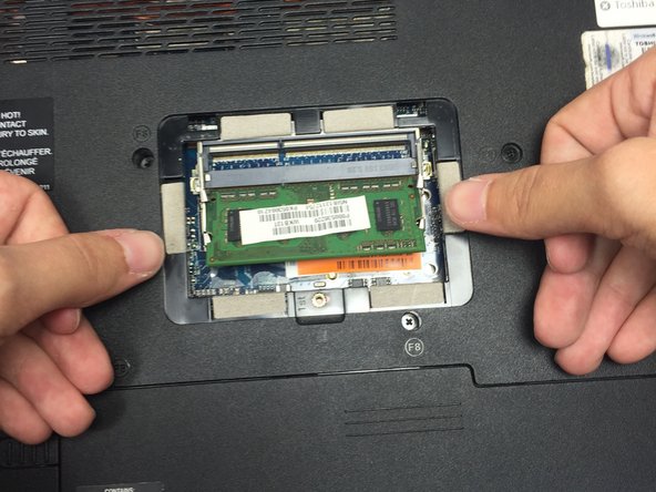

  3. Toshiba Satellite A665-S5170 RAM Replacement: crwdns2935265:03crwdnd2935265:01crwdnd2935265:02crwdne2935265:0 Toshiba Satellite A665-S5170 RAM Replacement: crwdns2935265:03crwdnd2935265:02crwdnd2935265:02crwdne2935265:0
    • With your thumbs, press down on the small silver clamps on the left and right edges of the upper green RAM chip until the clamps release the chip.
    • When the chip is released, it will pop up and stick out at a 45 degree angle from the computer.
  4. Toshiba Satellite A665-S5170 RAM Replacement: crwdns2935265:04crwdnd2935265:01crwdnd2935265:01crwdne2935265:0
    • Remove the upper RAM chip from its socket by gently gripping the left and right edges with your fingers and pulling the chip towards your body until it slides completely free of the computer.
  5. Toshiba Satellite A665-S5170 RAM Replacement: crwdns2935265:05crwdnd2935265:01crwdnd2935265:02crwdne2935265:0 Toshiba Satellite A665-S5170 RAM Replacement: crwdns2935265:05crwdnd2935265:02crwdnd2935265:02crwdne2935265:0
    • With your thumbs, press down on the small silver clamps on the left and right edges of the lower green RAM chip until the clamps release the chip.
  6. Toshiba Satellite A665-S5170 RAM Replacement: crwdns2935265:06crwdnd2935265:01crwdnd2935265:01crwdne2935265:0
    • Remove the lower RAM chip from its socket by gently gripping the left and right edges with your fingers and pulling the chip towards your body until it slides completely free of the computer.
