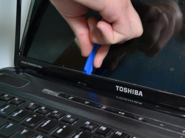

    • Peel back all four circular stickers that are located at each corner of the computer frame.
    • A pair of fine point tweezers was used to complete this.

    • Pry the frame of the screen away from the computer.
    • A prying tool was used by inserting it in the crack between the frame and the screen and running it along the edges of the frame.
