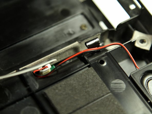

  9. Toshiba Satellite A65-S126 Speaker Replacement, Speaker: crwdns2935265:09crwdnd2935265:01crwdnd2935265:02crwdne2935265:0 Toshiba Satellite A65-S126 Speaker Replacement, Speaker: crwdns2935265:09crwdnd2935265:02crwdnd2935265:02crwdne2935265:0
    • Locate the plug for the speaker wires on the bottom of the laptop.
  10. Toshiba Satellite A65-S126 Speaker Replacement: crwdns2935265:010crwdnd2935265:01crwdnd2935265:01crwdne2935265:0
    • Unplug the speaker wire connector.
  11. Toshiba Satellite A65-S126 Speaker Replacement: crwdns2935265:011crwdnd2935265:01crwdnd2935265:01crwdne2935265:0
    • Remove the speakers by sliding them straight up. They should slide out with ease.
