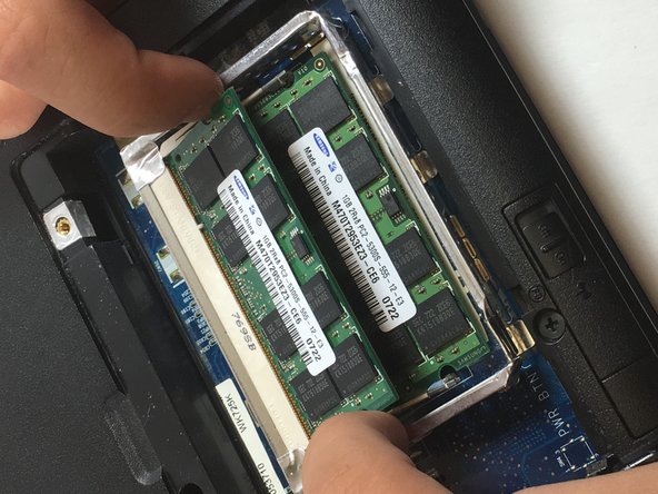

  3. Toshiba Satellite A215-S4757 RAM Replacement: crwdns2935265:03crwdnd2935265:01crwdnd2935265:03crwdne2935265:0 Toshiba Satellite A215-S4757 RAM Replacement: crwdns2935265:03crwdnd2935265:02crwdnd2935265:03crwdne2935265:0 Toshiba Satellite A215-S4757 RAM Replacement: crwdns2935265:03crwdnd2935265:03crwdnd2935265:03crwdne2935265:0
    • Identify the clips on each side of both RAM components that are holding them in place.
    • To remove each component, simply push each clip gently outward until the component pops upward.

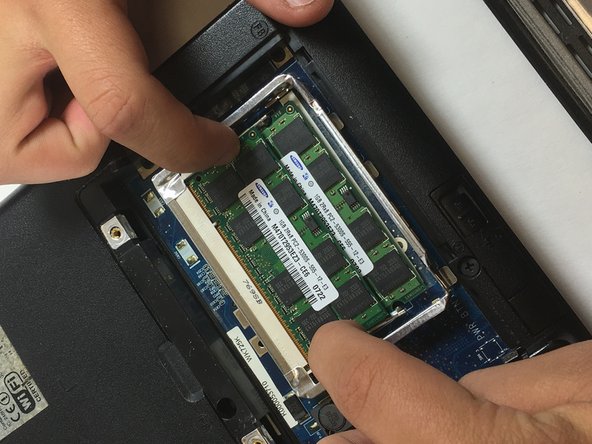

  4. Toshiba Satellite A215-S4757 RAM Replacement: crwdns2935265:04crwdnd2935265:01crwdnd2935265:01crwdne2935265:0
    • Gently pull and remove the RAM component, and repeat for the second component laying underneath the first.

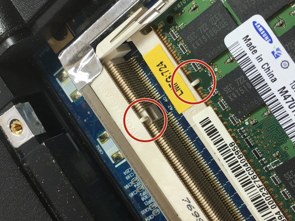

  5. Toshiba Satellite A215-S4757 RAM Replacement: crwdns2935265:05crwdnd2935265:01crwdnd2935265:02crwdne2935265:0 Toshiba Satellite A215-S4757 RAM Replacement: crwdns2935265:05crwdnd2935265:02crwdnd2935265:02crwdne2935265:0
    • Be sure to match each RAM components female insert, with the laptops male insert during reassembly. If you do not reinstall the components correctly your motherboard may fry.
