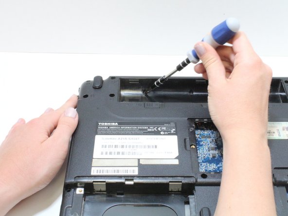

  10. Toshiba Satellite A215 S4697 Screen Replacement: crwdns2935265:010crwdnd2935265:01crwdnd2935265:01crwdne2935265:0
    • Unscrew the two 8mm Phillips #1 screws inside the RAM compartment.
  11. Toshiba Satellite A215 S4697 Screen Replacement: crwdns2935265:011crwdnd2935265:01crwdnd2935265:02crwdne2935265:0 Toshiba Satellite A215 S4697 Screen Replacement: crwdns2935265:011crwdnd2935265:02crwdnd2935265:02crwdne2935265:0
    • Remove the three 3mm Phillips #1 screws inside the battery compartment.

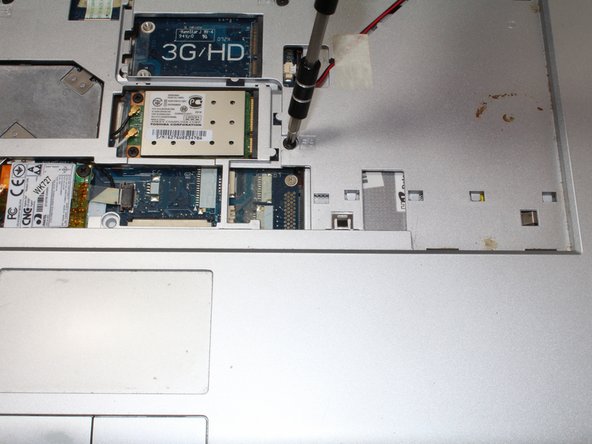

  12. Toshiba Satellite A215 S4697 Screen Replacement: crwdns2935265:012crwdnd2935265:01crwdnd2935265:02crwdne2935265:0 Toshiba Satellite A215 S4697 Screen Replacement: crwdns2935265:012crwdnd2935265:02crwdnd2935265:02crwdne2935265:0
    • Turn computer over and open lid.
    • Make sure all the screws are cleared off the device before you flip the device over.
    • Remove the four 8mm Phillips #1 screws in the slot where the keyboard sat.

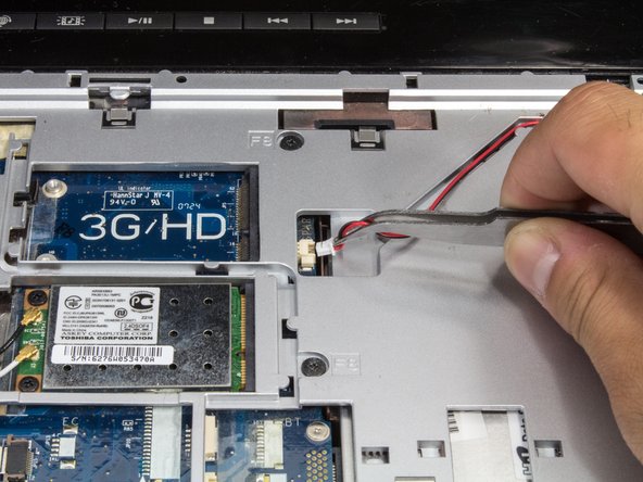

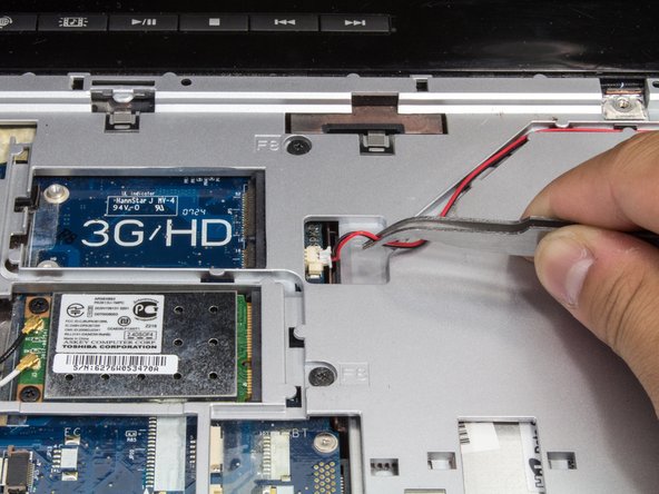

  13. Toshiba Satellite A215 S4697 Screen Replacement: crwdns2935265:013crwdnd2935265:01crwdnd2935265:03crwdne2935265:0 Toshiba Satellite A215 S4697 Screen Replacement: crwdns2935265:013crwdnd2935265:02crwdnd2935265:03crwdne2935265:0 Toshiba Satellite A215 S4697 Screen Replacement: crwdns2935265:013crwdnd2935265:03crwdnd2935265:03crwdne2935265:0
    • Locate the speaker cables near the top right corner.
    • Use tweezers to carefully disconnect the cable.

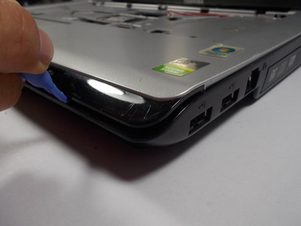

  17. Toshiba Satellite A215 S4697 Screen Replacement: crwdns2935265:017crwdnd2935265:01crwdnd2935265:03crwdne2935265:0 Toshiba Satellite A215 S4697 Screen Replacement: crwdns2935265:017crwdnd2935265:02crwdnd2935265:03crwdne2935265:0 Toshiba Satellite A215 S4697 Screen Replacement: crwdns2935265:017crwdnd2935265:03crwdnd2935265:03crwdne2935265:0
    • Using a plastic opening tool, insert into slit around laptop and separate the silver frame from black bottom.
    • The black lip on the front of the laptop is part of the top silver frame.
    • Lift frame away from laptop.
