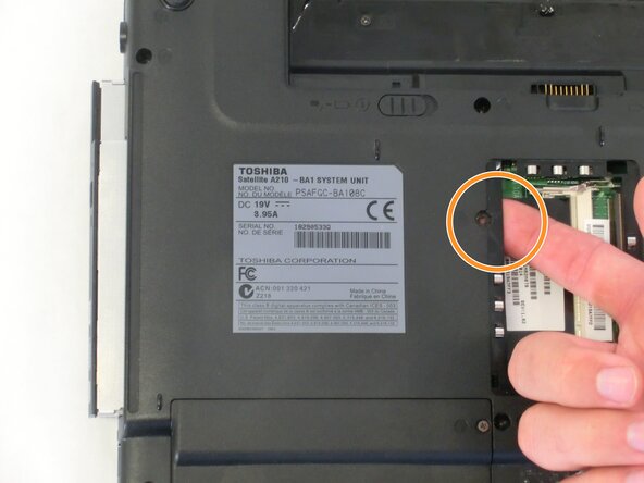

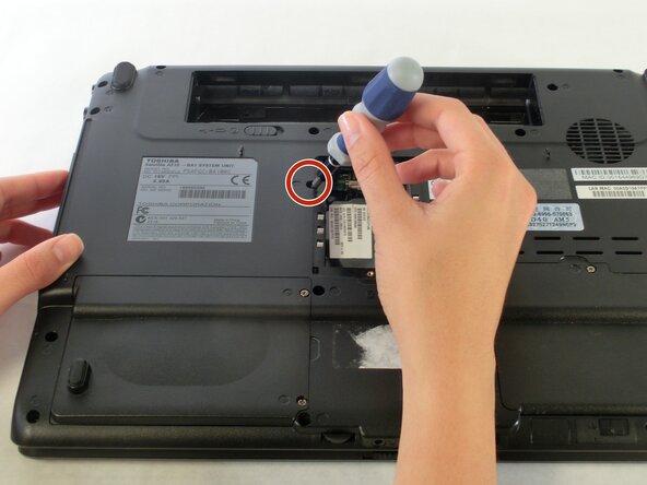

  5. Toshiba Satellite A210 Optical Disc Drive Replacement, Optical Disc Drive: crwdns2935265:05crwdnd2935265:01crwdnd2935265:03crwdne2935265:0 Toshiba Satellite A210 Optical Disc Drive Replacement, Optical Disc Drive: crwdns2935265:05crwdnd2935265:02crwdnd2935265:03crwdne2935265:0 Toshiba Satellite A210 Optical Disc Drive Replacement, Optical Disc Drive: crwdns2935265:05crwdnd2935265:03crwdnd2935265:03crwdne2935265:0
    • Use a PH0 screwdriver to remove the screw holding the optical drive in place.
    • Using your index finger, push the metal tab inside the RAM bay which is located directly underneath the screw-hole.
    • The optical drive will then slide out.
