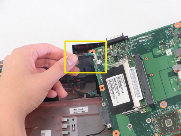

  16. Toshiba Satellite A210 Motherboard Replacement, Motherboard: crwdns2935265:016crwdnd2935265:01crwdnd2935265:01crwdne2935265:0
    • First, remove the one screw with a PH1 screwdriver.
    • Next, remove the black connector marked by the yellow box.

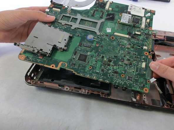

  19. Toshiba Satellite A210 Motherboard Replacement: crwdns2935265:019crwdnd2935265:01crwdnd2935265:03crwdne2935265:0 Toshiba Satellite A210 Motherboard Replacement: crwdns2935265:019crwdnd2935265:02crwdnd2935265:03crwdne2935265:0 Toshiba Satellite A210 Motherboard Replacement: crwdns2935265:019crwdnd2935265:03crwdnd2935265:03crwdne2935265:0
    • Gently slide the plastic opening tool underneath and around the motherboard.
    • Do not force the motherboard out. If the motherboard breaks, it is not repairable. You will have to buy a new one.
    • After the motherboard is free of the plastic casing, do not pull it all the way out. There is still a connector on the underside of it.
    • Remove the connector on the underside using your fingers.
