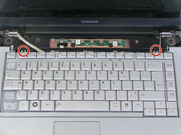

  4. Toshiba Satellite A210 Fan Replacement, Keyboard: crwdns2935265:04crwdnd2935265:01crwdnd2935265:01crwdne2935265:0
    • Unscrew the 4 highlighted screws with a PH1 screwdriver.

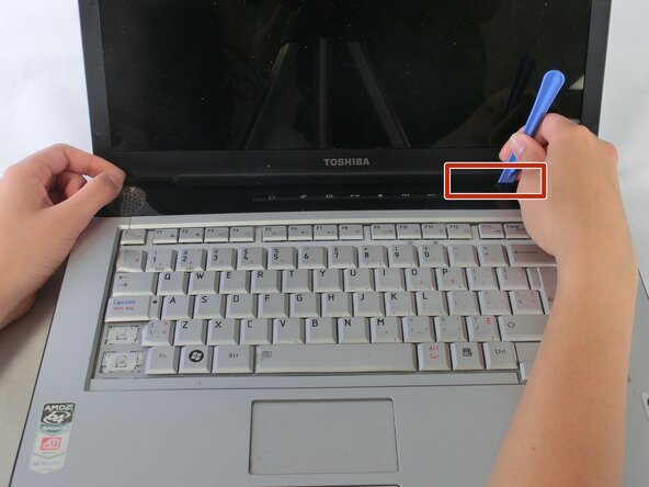

  5. Toshiba Satellite A210 Fan Replacement: crwdns2935265:05crwdnd2935265:01crwdnd2935265:03crwdne2935265:0 Toshiba Satellite A210 Fan Replacement: crwdns2935265:05crwdnd2935265:02crwdnd2935265:03crwdne2935265:0 Toshiba Satellite A210 Fan Replacement: crwdns2935265:05crwdnd2935265:03crwdnd2935265:03crwdne2935265:0
    • Orient the laptop so that the screen is open and facing you.
    • Slide the plastic opening tool underneath the top edge of the black plastic insert.
    • Pull it off and set aside.

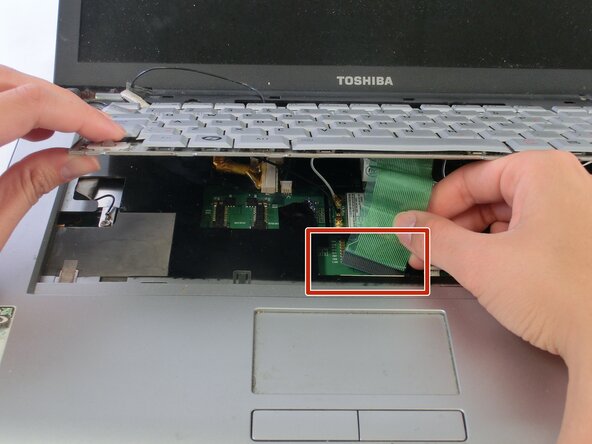

  6. Toshiba Satellite A210 Fan Replacement: crwdns2935265:06crwdnd2935265:01crwdnd2935265:02crwdne2935265:0 Toshiba Satellite A210 Fan Replacement: crwdns2935265:06crwdnd2935265:02crwdnd2935265:02crwdne2935265:0
    • Remove the 2 PH1 screws.
    • Lift the keyboard from the top being carful not to remove it fully. There is still a ribbon cable that connects the keyboard to the laptop.
  7. Toshiba Satellite A210 Fan Replacement: crwdns2935265:07crwdnd2935265:01crwdnd2935265:01crwdne2935265:0
    • Disconnect the keyboard ribbon cable and remove the keyboard from the laptop.

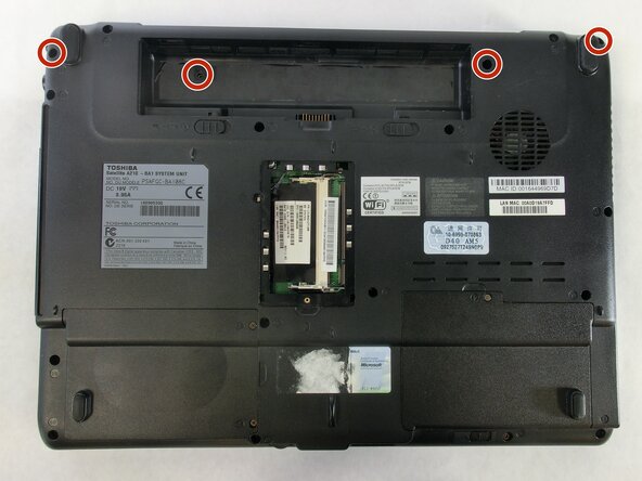

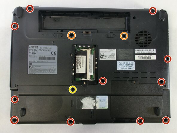

  8. Toshiba Satellite A210 Fan Replacement, Fan: crwdns2935265:08crwdnd2935265:01crwdnd2935265:01crwdne2935265:0
    • Close the laptop and flip it over.
    • Unscrew the 11 red circled screws with a PH1 screwdriver. These screws are larger in size.
    • Unscrew the 2 orange circled screws with a PH1 screwdriver. These screws are shorter and thicker than the previous.
    • Unscrew the 1 yellow circled screw with a PH1 screwdriver. This screw is longer and thinner than the previous.

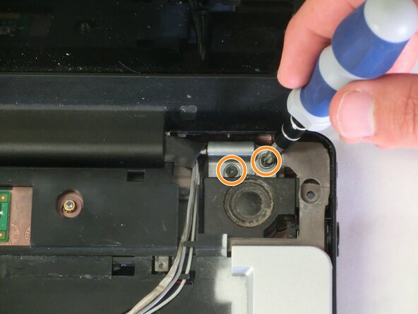

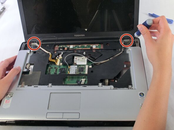

  9. Toshiba Satellite A210 Fan Replacement: crwdns2935265:09crwdnd2935265:01crwdnd2935265:03crwdne2935265:0 Toshiba Satellite A210 Fan Replacement: crwdns2935265:09crwdnd2935265:02crwdnd2935265:03crwdne2935265:0 Toshiba Satellite A210 Fan Replacement: crwdns2935265:09crwdnd2935265:03crwdnd2935265:03crwdne2935265:0

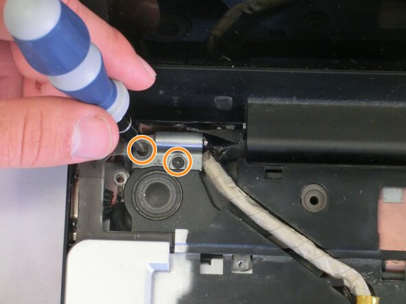

    • Flip the laptop over and open it so that the screen is facing you.
    • Locate the hinges on either side of the screen, which secure the display to the body of the laptop.
    • Unscrew the 2 screws in each hinge with a PH1 screwdriver.
    • The display is no longer connected to the laptop and could fall. Be careful not to drop it during the next steps.

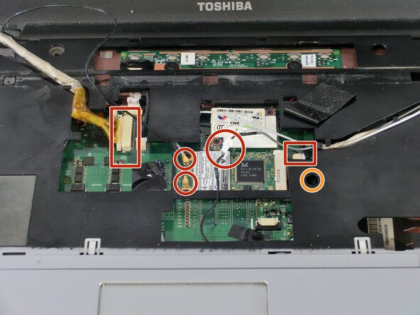

  10. Toshiba Satellite A210 Fan Replacement: crwdns2935265:010crwdnd2935265:01crwdnd2935265:03crwdne2935265:0 Toshiba Satellite A210 Fan Replacement: crwdns2935265:010crwdnd2935265:02crwdnd2935265:03crwdne2935265:0 Toshiba Satellite A210 Fan Replacement: crwdns2935265:010crwdnd2935265:03crwdnd2935265:03crwdne2935265:0
    • Unfasten the connectors from the highlighted locations.
    • Disconnect by gently pulling on the fasteners which connect the wires to the laptop.
    • Pulling directly on the wires could cause permanent damage to the connectors or the wires themselves.
    • Unscrew the screw indicated by the yellow circle.

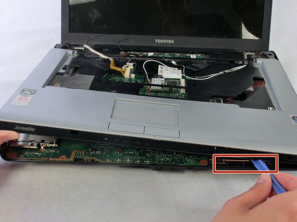

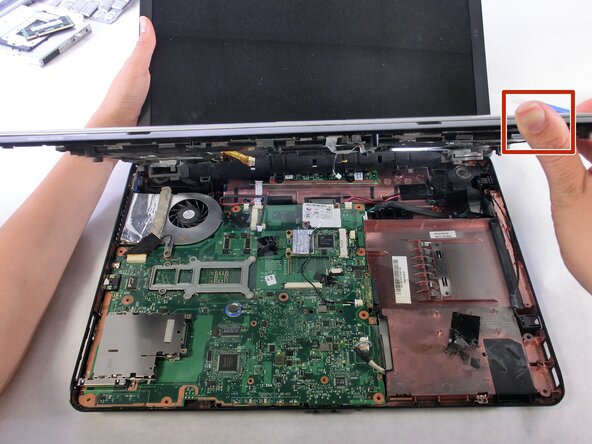

  11. Toshiba Satellite A210 Fan Replacement: crwdns2935265:011crwdnd2935265:01crwdnd2935265:02crwdne2935265:0 Toshiba Satellite A210 Fan Replacement: crwdns2935265:011crwdnd2935265:02crwdnd2935265:02crwdne2935265:0
    • Slide the plastic opening tool underneath the edges of the upper casing, which is shown in the images.
  12. Toshiba Satellite A210 Fan Replacement: crwdns2935265:012crwdnd2935265:01crwdnd2935265:01crwdne2935265:0
    • The LCD screen can now be removed from the laptop.
    • Lift the upper plastic casing and remove it from the lower half of the laptop.

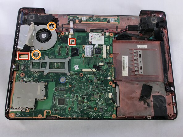

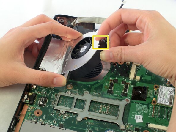

  13. Toshiba Satellite A210 Fan Replacement: crwdns2935265:013crwdnd2935265:01crwdnd2935265:03crwdne2935265:0 Toshiba Satellite A210 Fan Replacement: crwdns2935265:013crwdnd2935265:02crwdnd2935265:03crwdne2935265:0 Toshiba Satellite A210 Fan Replacement: crwdns2935265:013crwdnd2935265:03crwdnd2935265:03crwdne2935265:0
    • Unfasten the two connections shown.
    • Unscrew the two screws securing the fan to the laptop. Use a PH1 for the screw that is adjacent to the speaker and a PH0 for the other screw.
    • Lift up the fan and pull the black plastic tab away from the fan housing. Remove the fan.
    • Do not remove the metal fan housing. It is taped to a metal heat-sink and should not be removed.

THANKS , very useful,clear, lifesaver guide !!!
ANDREAS - crwdns2934203:0crwdne2934203:0
Very good. I am impressed. Only one screw over at the end, for me that’s good! And the fan is sooo much quieter :)
