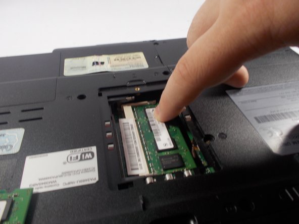

    • Identify the rectangular plastic RAM cover located in the bottom part of your laptop.
    • Remove the 4mm flat-head screws on the RAM cover.
    • Use a plastic opening tool to pry the RAM cover upward.
  2. Toshiba Satellite A205-S4577 RAM Replacement: crwdns2935265:02crwdnd2935265:01crwdnd2935265:01crwdne2935265:0
    • Remove the RAM cover.
  3. Toshiba Satellite A205-S4577 RAM Replacement: crwdns2935265:03crwdnd2935265:01crwdnd2935265:01crwdne2935265:0
    • Press the two tabs on the side of the PC2-5300 2 GB RAM Chip to unlatch it.
    • To remove the PC2-5300 2 GB RAM Chip, pull it out at a slightly upward angle.
  4. Toshiba Satellite A205-S4577 RAM Replacement: crwdns2935265:04crwdnd2935265:01crwdnd2935265:02crwdne2935265:0 Toshiba Satellite A205-S4577 RAM Replacement: crwdns2935265:04crwdnd2935265:02crwdnd2935265:02crwdne2935265:0
    • To replace the ram, insert the new PC2-5300 1 GB RAM Chip you have gathered back into the laptop.
    • Make sure the notch in the middle of the stick is lined up correctly and push firmly into place.
    • Once pushed firmly into place, firmly push down and latch the RAM sticks to the laptop. Repeat process for additional RAM sticks.
  5. Toshiba Satellite A205-S4577 RAM Replacement: crwdns2935265:05crwdnd2935265:01crwdnd2935265:02crwdne2935265:0 Toshiba Satellite A205-S4577 RAM Replacement: crwdns2935265:05crwdnd2935265:02crwdnd2935265:02crwdne2935265:0
    • To replace the ram, insert the new RAM sticks you have back into the computer.
    • Once pushed firmly into place, firmly push down and latch the RAM sticks to the computer. Repeat process for additional RAM sticks.
  6. Toshiba Satellite A205-S4577 RAM Replacement: crwdns2935265:06crwdnd2935265:01crwdnd2935265:01crwdne2935265:0
    • Screw the back plate of the RAM back onto the device.
