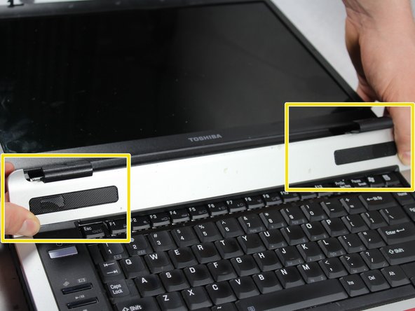

    • Turn the laptop back over so it is right-side up, with the cover facing up.
    • Open the laptop all the way so that the screen is horizontal with the body.
  4. Toshiba Satellite A105-S4074 Keyboard Replacement: crwdns2935265:04crwdnd2935265:01crwdnd2935265:03crwdne2935265:0 Toshiba Satellite A105-S4074 Keyboard Replacement: crwdns2935265:04crwdnd2935265:02crwdnd2935265:03crwdne2935265:0 Toshiba Satellite A105-S4074 Keyboard Replacement: crwdns2935265:04crwdnd2935265:03crwdnd2935265:03crwdne2935265:0

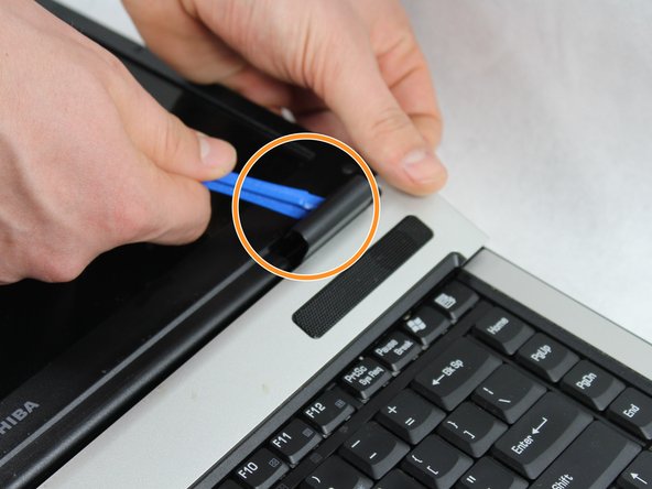

    • Using the iFixit plastic opening tool, pop up the left tab along the top of the panel that is connected to the hinge for the widescreen display.
    • Using the plastic opening tool, pop up the right tab along the top of the panel that is connected to the hinge for the widescreen display.
    • Pry up and remove the cover panel that is located above the keyboard.

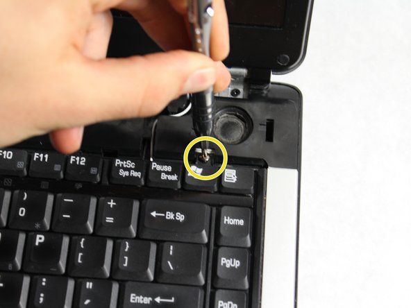

    • Position laptop so that both screws connecting the keyboard to the laptop are visible.
    • Unscrew the left 3.0 mm screw that is holding the keyboard onto the laptop using the Phillips #0 screwdriver.
    • Unscrew the right 3.0 mm screw that is holding the keyboard onto the laptop using the Phillips #0 screwdriver.
