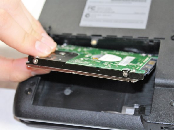

  4. Toshiba Satellite A105-S4074 Hard Drive Replacement: crwdns2935265:04crwdnd2935265:01crwdnd2935265:03crwdne2935265:0 Toshiba Satellite A105-S4074 Hard Drive Replacement: crwdns2935265:04crwdnd2935265:02crwdnd2935265:03crwdne2935265:0 Toshiba Satellite A105-S4074 Hard Drive Replacement: crwdns2935265:04crwdnd2935265:03crwdnd2935265:03crwdne2935265:0
    • You should now have full access to the hard drive.
    • Slide the hard drive to the left.
    • Gently lift the hard drive from the side closest to you and remove it.
To reassemble your device after replacing the hard drive, follow these instructions in reverse order.
