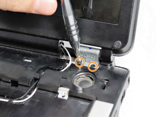

    • Unscrew the two 4.0 mm screws from the left hinge located at the base of the widescreen display using the Phillips #1 screwdriver.
    • Unscrew the two 4.0 mm screws from the right hinge located at the base of the widescreen display using the Phillips #1 screwdriver.

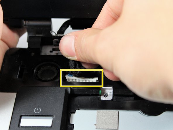

    • Gently disconnect the black video cable that connects the screen to the motherboard.

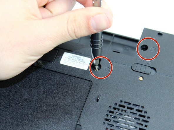

    • Turn the laptop over with battery slot facing away from you.
    • Remove the fifteen 6.0 mm (B6) screws from bottom of laptop using the Phillips #1 screwdriver.
    • Remove the two 5.0 mm (F4) screws from the bottom of the laptop using the Phillips #1 screwdriver.

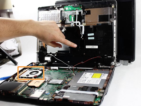

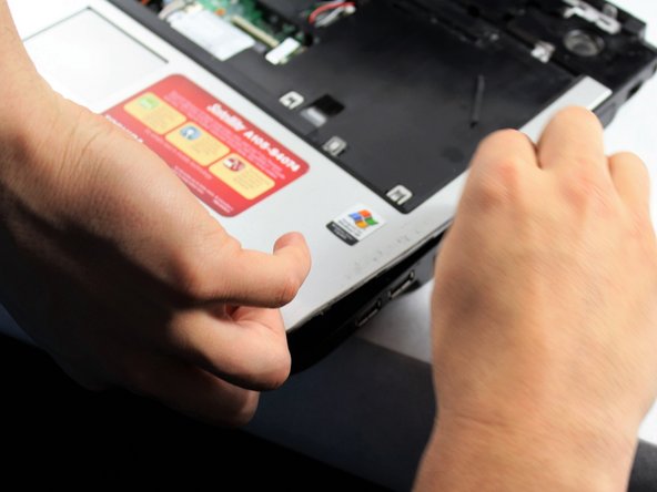

    • Using the plastic opening tool, gently pry up on the upper casing of the laptop separating it from the lower casing.
    • Slowly work the tool around the sides of the case until the two pieces are completely separated from each other.
    • Remove the upper casing from the bottom casing using your hands.
    • With the laptop separated, you should be able to see the CPU fan.
