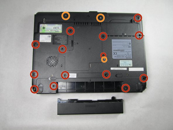

    • Turn the laptop over, so that you are now looking at the bottom of the laptop.
    • Using the Phillips #1 screwdriver remove the fourteen 6mm screws.
    • Using the Phillips #1 screwdriver remove the three 4mm screws.
    • Before beginning this guide, make sure you have disconnected the seven wires described in step 4 of the keyboard guide (the guide that proceeds this one).

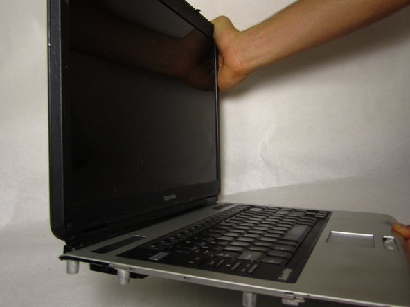

  7. Toshiba Satellite A105-S4011 Optical Drive Replacement: crwdns2935265:07crwdnd2935265:01crwdnd2935265:01crwdne2935265:0
    • Completely remove the display piece by pulling between the silver display-component and the black bottom-component. The display- component is an all-in-one component pictured here.
    • You may need to use the plastic opening tool to pry the two sections apart
    • Manufacturer sells the display piece, pictured here, as a complete piece for replacement purposes.
