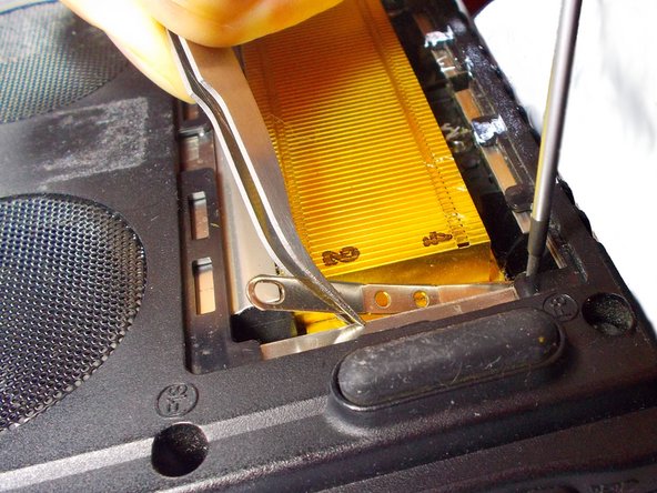

  4. Toshiba Satellite 2435-S255 Heat Sink Replacement, Remove the Heat Sink Brackets: crwdns2935265:04crwdnd2935265:01crwdnd2935265:02crwdne2935265:0 Toshiba Satellite 2435-S255 Heat Sink Replacement, Remove the Heat Sink Brackets: crwdns2935265:04crwdnd2935265:02crwdnd2935265:02crwdne2935265:0
    • This step can be kind of tricky. Using a PH00 screwdriver, remove the eight indicated screws. The screws in the four corners are 5mm while the four screws on the left and right sides are 3mm.
    • It doesn’t matter which order you unscrew them when removing the heat sink.
    • If you’re removing one of the top or bottom (red) ones for that side last, make sure to use a pair of tweezers to hold the other end so that the bracket doesn’t drop into the laptop.
