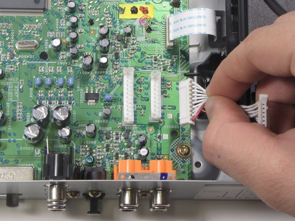

  8. Toshiba SD-K740 Inverter Board Replacement: crwdns2935265:08crwdnd2935265:01crwdnd2935265:02crwdne2935265:0 Toshiba SD-K740 Inverter Board Replacement: crwdns2935265:08crwdnd2935265:02crwdnd2935265:02crwdne2935265:0
    • Remove the first of two ribbon cables connected to the motherboard by pulling vertically.

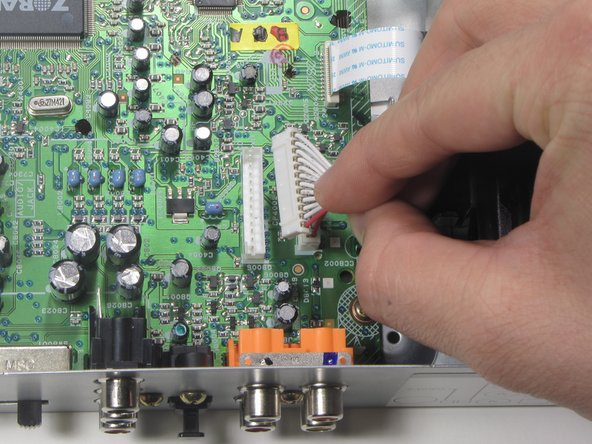

  9. Toshiba SD-K740 Inverter Board Replacement: crwdns2935265:09crwdnd2935265:01crwdnd2935265:02crwdne2935265:0 Toshiba SD-K740 Inverter Board Replacement: crwdns2935265:09crwdnd2935265:02crwdnd2935265:02crwdne2935265:0
    • Remove the second of two ribbon cables connected to the motherboard by pulling vertically.

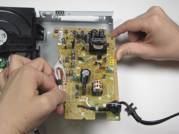

  12. Toshiba SD-K740 Inverter Board Replacement: crwdns2935265:012crwdnd2935265:01crwdnd2935265:01crwdne2935265:0
    • Remove the three .303 inch screws attaching the inverter board to the casing using a #0 Phillips screwdriver.
  13. Toshiba SD-K740 Inverter Board Replacement: crwdns2935265:013crwdnd2935265:01crwdnd2935265:01crwdne2935265:0
    • Push the inverter board forward and to the left to remove from the holding ledges.
  14. Toshiba SD-K740 Inverter Board Replacement: crwdns2935265:014crwdnd2935265:01crwdnd2935265:02crwdne2935265:0 Toshiba SD-K740 Inverter Board Replacement: crwdns2935265:014crwdnd2935265:02crwdnd2935265:02crwdne2935265:0
    • Lift the inverter board from the back end and pull toward you to complete removal.
