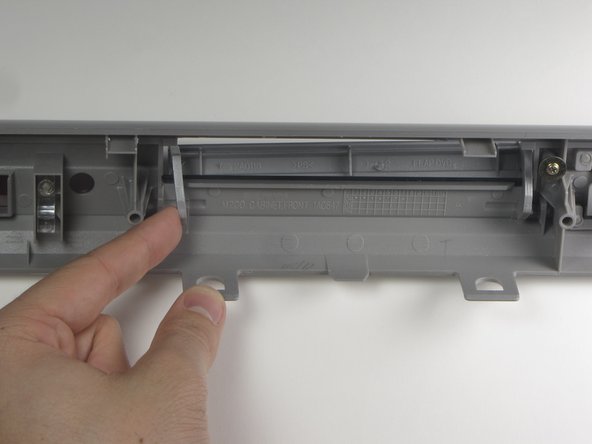

  7. Toshiba SD-K740 Front Flap Tray Door Replacement, Front Flap Tray Door: crwdns2935265:07crwdnd2935265:01crwdnd2935265:02crwdne2935265:0 Toshiba SD-K740 Front Flap Tray Door Replacement, Front Flap Tray Door: crwdns2935265:07crwdnd2935265:02crwdnd2935265:02crwdne2935265:0
    • On back side of front panel very carefully apply pressure to the left hand side of the flap hinge.
    • There is just enough tolerance in the plastic to allow removal, be careful of brittle plastic.
  8. Toshiba SD-K740 Front Flap Tray Door Replacement: crwdns2935265:08crwdnd2935265:01crwdnd2935265:01crwdne2935265:0
    • Once the peg is free from the left restraint, carefully remove the left part of the flap.
    • Carefully remove the right peg from the restraint.
    • Do not pull away from the front panel because the spring is still attached.
    • Do not force the plastic.
  9. Toshiba SD-K740 Front Flap Tray Door Replacement: crwdns2935265:09crwdnd2935265:01crwdnd2935265:01crwdne2935265:0
    • Remove the spring from the end of the right peg by pulling the door away from the spring.
    • Do not pull away from the front panel until the spring has been removed from the flap.
