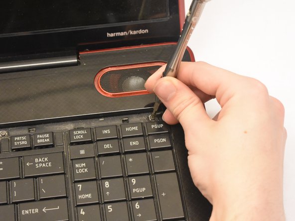

  4. Toshiba Qosmio X505-Q860 Keyboard Replacement: crwdns2935265:04crwdnd2935265:01crwdnd2935265:02crwdne2935265:0 Toshiba Qosmio X505-Q860 Keyboard Replacement: crwdns2935265:04crwdnd2935265:02crwdnd2935265:02crwdne2935265:0
    • Unscrew the four 3.6mm long JIS #0 screws using the JIS screwdriver.
