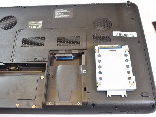

    • Turn off laptop before starting.
    • Flip the switch on the right to the unlocked position.
  2. Toshiba Qosmio X505-Q860 Hard Disk Drive Replacement: crwdns2935265:02crwdnd2935265:01crwdnd2935265:03crwdne2935265:0 Toshiba Qosmio X505-Q860 Hard Disk Drive Replacement: crwdns2935265:02crwdnd2935265:02crwdnd2935265:03crwdne2935265:0 Toshiba Qosmio X505-Q860 Hard Disk Drive Replacement: crwdns2935265:02crwdnd2935265:03crwdnd2935265:03crwdne2935265:0
    • Hold the switch on the left and pull the battery up towards you, using the marked tab, to take it out.
  3. Toshiba Qosmio X505-Q860 Hard Disk Drive Replacement, Hard Disk Drive Cover Panel: crwdns2935265:03crwdnd2935265:01crwdnd2935265:02crwdne2935265:0 Toshiba Qosmio X505-Q860 Hard Disk Drive Replacement, Hard Disk Drive Cover Panel: crwdns2935265:03crwdnd2935265:02crwdnd2935265:02crwdne2935265:0
    • Use a JIS #0 screwdriver to unscrew the two 4.6 mm screws at the base of the casing.
    • Pull off the part of the case that's now loose by the indicated tab.

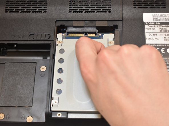

  4. Toshiba Qosmio X505-Q860 Hard Disk Drive Replacement, Hard Disk Drive: crwdns2935265:04crwdnd2935265:01crwdnd2935265:02crwdne2935265:0 Toshiba Qosmio X505-Q860 Hard Disk Drive Replacement, Hard Disk Drive: crwdns2935265:04crwdnd2935265:02crwdnd2935265:02crwdne2935265:0
    • Use the JIS screwdriver head to remove the 3.7mm long JIS #0 screws at the base of the hard drive.
  5. Toshiba Qosmio X505-Q860 Hard Disk Drive Replacement: crwdns2935265:05crwdnd2935265:01crwdnd2935265:03crwdne2935265:0 Toshiba Qosmio X505-Q860 Hard Disk Drive Replacement: crwdns2935265:05crwdnd2935265:02crwdnd2935265:03crwdne2935265:0 Toshiba Qosmio X505-Q860 Hard Disk Drive Replacement: crwdns2935265:05crwdnd2935265:03crwdnd2935265:03crwdne2935265:0
    • Next, use the pull tab to pull down and detach the hard drive from the connector.
    • Now the hard drive is loose and can be lifted straight out of the laptop.
