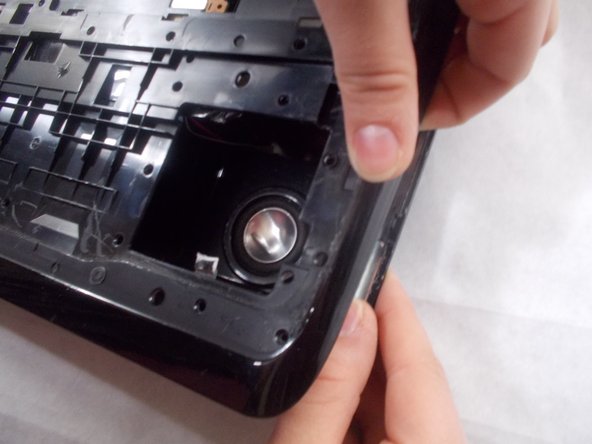

    • Insert the iFixit opening tool into the side of the computer that separates the top and bottom of the laptop. Move the tool along the edge of the laptop until the cover can be separated from the device.
    • Do not remove the panel from the device, as you'll need to disconnect cables before the component can be fully removed.

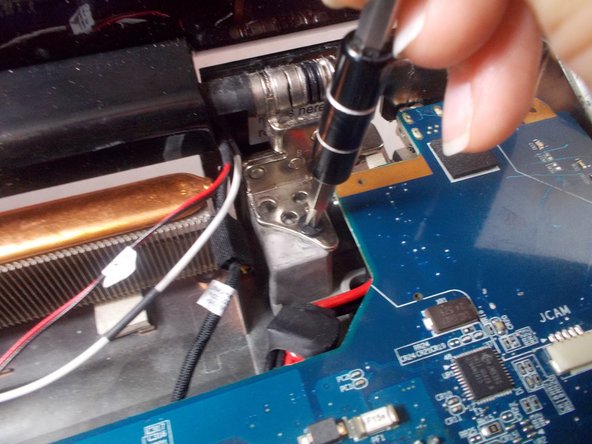

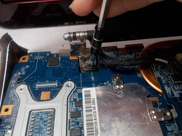

  9. Toshiba Qosmio X305-Q704 Screen Replacement: crwdns2935265:09crwdnd2935265:01crwdnd2935265:03crwdne2935265:0 Toshiba Qosmio X305-Q704 Screen Replacement: crwdns2935265:09crwdnd2935265:02crwdnd2935265:03crwdne2935265:0 Toshiba Qosmio X305-Q704 Screen Replacement: crwdns2935265:09crwdnd2935265:03crwdnd2935265:03crwdne2935265:0
    • Remove the 6 mm screws holding the screen on to the laptop using a Phillips #0 screwdriver.
  10. Toshiba Qosmio X305-Q704 Screen Replacement: crwdns2935265:010crwdnd2935265:01crwdnd2935265:02crwdne2935265:0 Toshiba Qosmio X305-Q704 Screen Replacement: crwdns2935265:010crwdnd2935265:02crwdnd2935265:02crwdne2935265:0
    • Remove the screen from the laptop.
