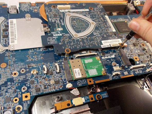

  11. Toshiba Qosmio X305-Q704 Fan Replacement, Fan: crwdns2935265:011crwdnd2935265:01crwdnd2935265:02crwdne2935265:0 Toshiba Qosmio X305-Q704 Fan Replacement, Fan: crwdns2935265:011crwdnd2935265:02crwdnd2935265:02crwdne2935265:0
    • Remove the four 8 mm screws holding the two circuit boards together using a Phillips #0 screwdriver.

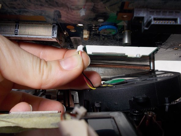

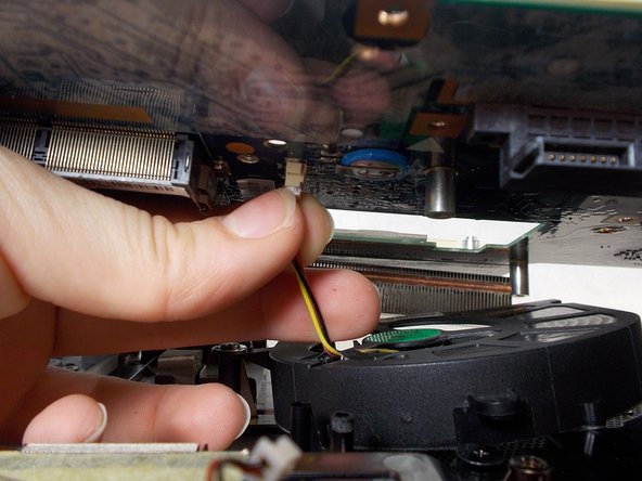

  16. Toshiba Qosmio X305-Q704 Fan Replacement: crwdns2935265:016crwdnd2935265:01crwdnd2935265:03crwdne2935265:0 Toshiba Qosmio X305-Q704 Fan Replacement: crwdns2935265:016crwdnd2935265:02crwdnd2935265:03crwdne2935265:0 Toshiba Qosmio X305-Q704 Fan Replacement: crwdns2935265:016crwdnd2935265:03crwdnd2935265:03crwdne2935265:0
    • Disconnect the wire underneath connecting the fan to the circuit board.

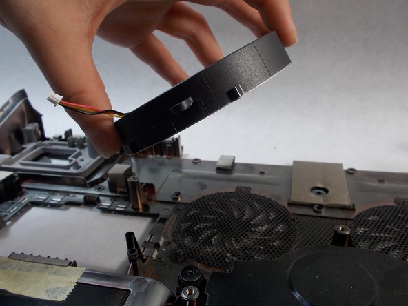

  18. Toshiba Qosmio X305-Q704 Fan Replacement: crwdns2935265:018crwdnd2935265:01crwdnd2935265:02crwdne2935265:0 Toshiba Qosmio X305-Q704 Fan Replacement: crwdns2935265:018crwdnd2935265:02crwdnd2935265:02crwdne2935265:0
    • Lift the fan and remove it from the device.
