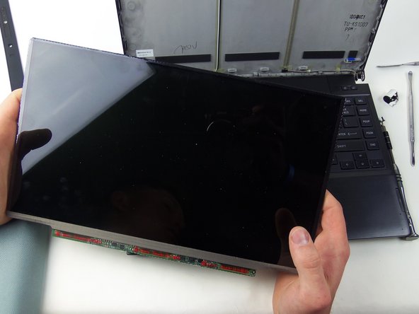

  4. Toshiba Portege R835-P88 Screen Replacement: crwdns2935265:04crwdnd2935265:01crwdnd2935265:01crwdne2935265:0
    • Remove the plastic bezel by lightly prying on it. It will pop when it starts to come loose.

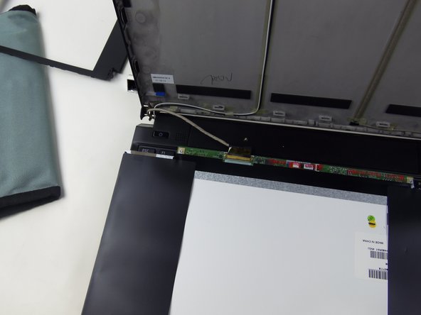

  5. Toshiba Portege R835-P88 Screen Replacement: crwdns2935265:05crwdnd2935265:01crwdnd2935265:02crwdne2935265:0 Toshiba Portege R835-P88 Screen Replacement: crwdns2935265:05crwdnd2935265:02crwdnd2935265:02crwdne2935265:0
    • Remove tape from around cord attached to the bottom of the screen.
    • Place the screen on top of the keyboard

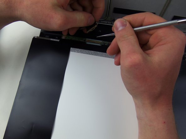

  6. Toshiba Portege R835-P88 Screen Replacement: crwdns2935265:06crwdnd2935265:01crwdnd2935265:03crwdne2935265:0 Toshiba Portege R835-P88 Screen Replacement: crwdns2935265:06crwdnd2935265:02crwdnd2935265:03crwdne2935265:0 Toshiba Portege R835-P88 Screen Replacement: crwdns2935265:06crwdnd2935265:03crwdnd2935265:03crwdne2935265:0
    • Remove the cord from the screen by cutting the tape where the two fittings meet. After that pull them apart.
