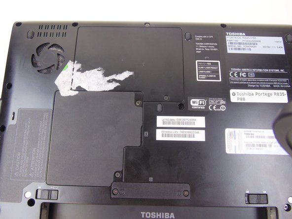

  2. Toshiba Portege R835-P88 Cooling Fan Replacement: crwdns2935265:02crwdnd2935265:01crwdnd2935265:03crwdne2935265:0 Toshiba Portege R835-P88 Cooling Fan Replacement: crwdns2935265:02crwdnd2935265:02crwdnd2935265:03crwdne2935265:0 Toshiba Portege R835-P88 Cooling Fan Replacement: crwdns2935265:02crwdnd2935265:03crwdnd2935265:03crwdne2935265:0
    • Remove the three small covers from the bottom by removing two 11mm screws and three 5mm screws using a screwdriver #J000.
    • Remove the remaining screws from the bottom cover using phillips head screwdriver #PH00.

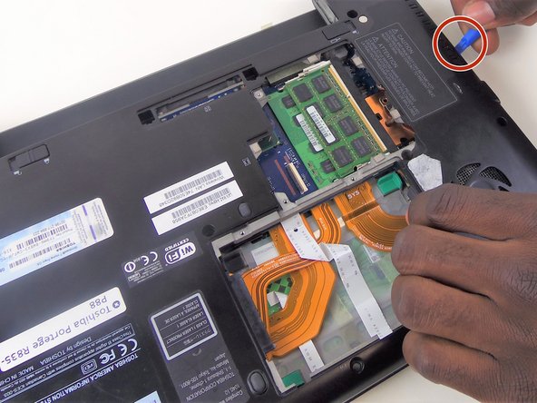

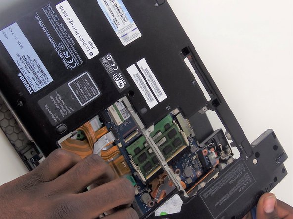

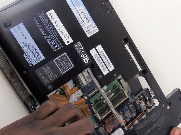

  3. Toshiba Portege R835-P88 Cooling Fan Replacement: crwdns2935265:03crwdnd2935265:01crwdnd2935265:03crwdne2935265:0 Toshiba Portege R835-P88 Cooling Fan Replacement: crwdns2935265:03crwdnd2935265:02crwdnd2935265:03crwdne2935265:0 Toshiba Portege R835-P88 Cooling Fan Replacement: crwdns2935265:03crwdnd2935265:03crwdnd2935265:03crwdne2935265:0
    • Pry the bottom cover using blue plastic ifixit prying tool.
    • Lift up and remove cover.

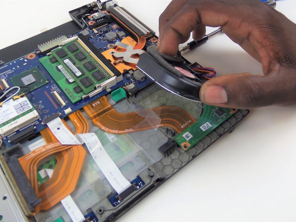

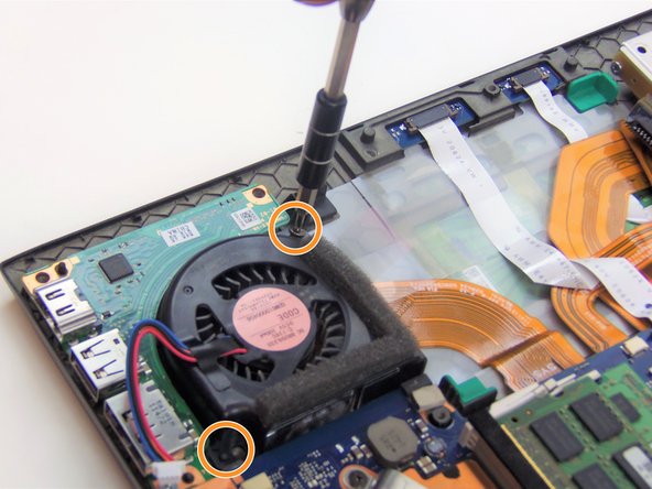

  4. Toshiba Portege R835-P88 Cooling Fan Replacement: crwdns2935265:04crwdnd2935265:01crwdnd2935265:03crwdne2935265:0 Toshiba Portege R835-P88 Cooling Fan Replacement: crwdns2935265:04crwdnd2935265:02crwdnd2935265:03crwdne2935265:0 Toshiba Portege R835-P88 Cooling Fan Replacement: crwdns2935265:04crwdnd2935265:03crwdnd2935265:03crwdne2935265:0
    • Disconnect the fan cable from the motherboard.
    • Remove two 3mm screws from fan using #J000 phillips head screwdriver.
    • Lift up and remove fan.
  5. Toshiba Portege R835-P88 Cooling Fan Replacement: crwdns2935265:05crwdnd2935265:01crwdnd2935265:03crwdne2935265:0 Toshiba Portege R835-P88 Cooling Fan Replacement: crwdns2935265:05crwdnd2935265:02crwdnd2935265:03crwdne2935265:0 Toshiba Portege R835-P88 Cooling Fan Replacement: crwdns2935265:05crwdnd2935265:03crwdnd2935265:03crwdne2935265:0
    • Replace the fan.
    • Assemble the Toshiba Portege R835-P88 following all disassembly steps in the reverse direction.
