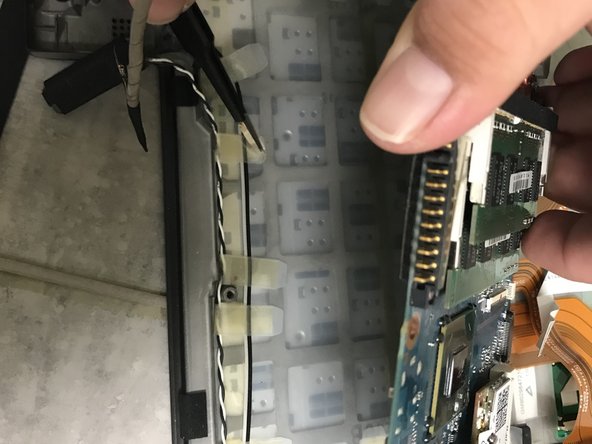

    • locate the speakers
    • Gently lift the motherboard to release the speaker cables
  9. Toshiba Portege R835-P56X Speaker Replacement: crwdns2935265:09crwdnd2935265:01crwdnd2935265:02crwdne2935265:0 Toshiba Portege R835-P56X Speaker Replacement: crwdns2935265:09crwdnd2935265:02crwdnd2935265:02crwdne2935265:0
    • Using the tweezers, gently remove the tape being used to hold down the speaker cables.
  10. Toshiba Portege R835-P56X Speaker Replacement: crwdns2935265:010crwdnd2935265:01crwdnd2935265:02crwdne2935265:0 Toshiba Portege R835-P56X Speaker Replacement: crwdns2935265:010crwdnd2935265:02crwdnd2935265:02crwdne2935265:0
    • Once the cable had been released you have successfully removed the speakers!
