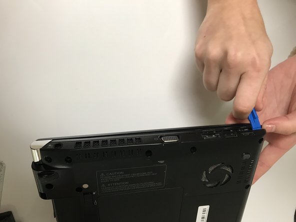

  4. Toshiba Portege R835-P56X Screen Replacement, Screen: crwdns2935265:04crwdnd2935265:01crwdnd2935265:03crwdne2935265:0 Toshiba Portege R835-P56X Screen Replacement, Screen: crwdns2935265:04crwdnd2935265:02crwdnd2935265:03crwdne2935265:0 Toshiba Portege R835-P56X Screen Replacement, Screen: crwdns2935265:04crwdnd2935265:03crwdnd2935265:03crwdne2935265:0

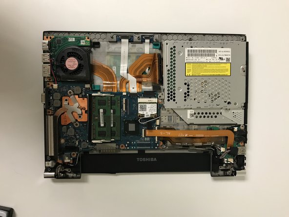

    • Use the screwdriver to unscrew 18 screws.
    • There may be an additional screw that is hidden under the covers that will also need to be removed.
    • Remove the back cover of the laptop.

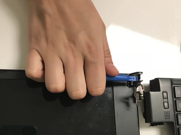

  7. Toshiba Portege R835-P56X Screen Replacement: crwdns2935265:07crwdnd2935265:01crwdnd2935265:02crwdne2935265:0 Toshiba Portege R835-P56X Screen Replacement: crwdns2935265:07crwdnd2935265:02crwdnd2935265:02crwdne2935265:0
    • Remove the chrome hinges using the blue prying tool. The hinges should pop right off without must effort.

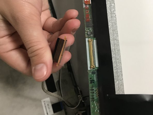

  12. Toshiba Portege R835-P56X Screen Replacement: crwdns2935265:012crwdnd2935265:01crwdnd2935265:02crwdne2935265:0 Toshiba Portege R835-P56X Screen Replacement: crwdns2935265:012crwdnd2935265:02crwdnd2935265:02crwdne2935265:0
    • Disconnect the grey mesh wire from underneath the unattached laptop screen.

Unfortantly, Step 4 is wrong, you actually have to remove all screws and there is another screw under the covers that's needed to be removed before the back will come off. Thankfully I figured this out, otherwise, with the steps that were provided I could of damaged the back! Please be careful!
