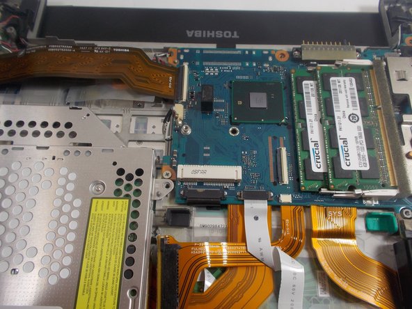

  11. Toshiba Portege R705-P35 Wi-Fi Card Replacement, Wi-Fi Card: crwdns2935265:011crwdnd2935265:01crwdnd2935265:01crwdne2935265:0
    • Use your fingers to disconnect the white and black cords from the Wi-Fi card.
  12. Toshiba Portege R705-P35 Wi-Fi Card Replacement: crwdns2935265:012crwdnd2935265:01crwdnd2935265:01crwdne2935265:0
    • Remove the two 3 mm screws from the Wi-Fi card using a Phillips #00 screwdriver.
  13. Toshiba Portege R705-P35 Wi-Fi Card Replacement: crwdns2935265:013crwdnd2935265:01crwdnd2935265:02crwdne2935265:0 Toshiba Portege R705-P35 Wi-Fi Card Replacement: crwdns2935265:013crwdnd2935265:02crwdnd2935265:02crwdne2935265:0
    • Pull the Wi-Fi card out of the laptop at a 45° angle.
