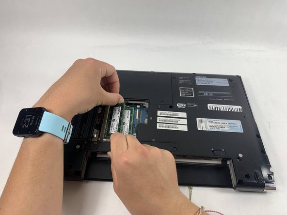

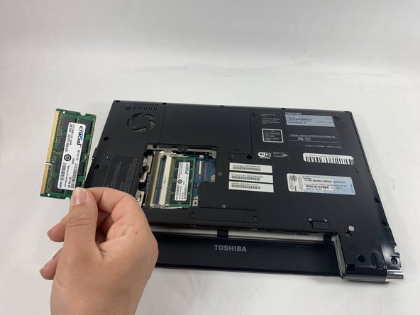

  5. Toshiba Portege R705-P35 RAM Replacement, RAM: crwdns2935265:05crwdnd2935265:01crwdnd2935265:02crwdne2935265:0 Toshiba Portege R705-P35 RAM Replacement, RAM: crwdns2935265:05crwdnd2935265:02crwdnd2935265:02crwdne2935265:0
    • Using a spudger or your fingers, push one of the metal rods on either side of the RAM stick away from it until you hear a light clicking noise.
    • Repeat this procedure with the other metal rod on the opposite side of the RAM stick.
  6. Toshiba Portege R705-P35 RAM Replacement: crwdns2935265:06crwdnd2935265:01crwdnd2935265:02crwdne2935265:0 Toshiba Portege R705-P35 RAM Replacement: crwdns2935265:06crwdnd2935265:02crwdnd2935265:02crwdne2935265:0
    • Once the RAM stick pops out to an angle, pull it outward.
