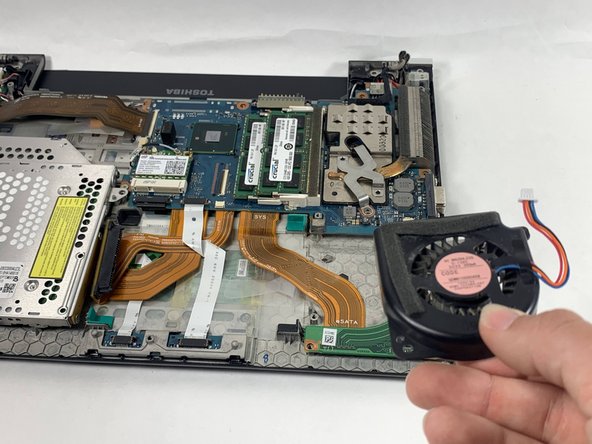

  11. Toshiba Portege R705-P35 Fan Replacement, Fan: crwdns2935265:011crwdnd2935265:01crwdnd2935265:01crwdne2935265:0
    • Remove the two 4 mm screws that join the fan to the device using a Phillips #00 screwdriver.
  12. Toshiba Portege R705-P35 Fan Replacement: crwdns2935265:012crwdnd2935265:01crwdnd2935265:01crwdne2935265:0
    • Use a spudger or your fingers to detach the plug that connects the fan to the motherboard.
  13. Toshiba Portege R705-P35 Fan Replacement: crwdns2935265:013crwdnd2935265:01crwdnd2935265:02crwdne2935265:0 Toshiba Portege R705-P35 Fan Replacement: crwdns2935265:013crwdnd2935265:02crwdnd2935265:02crwdne2935265:0
    • Remove the fan from the laptop.
