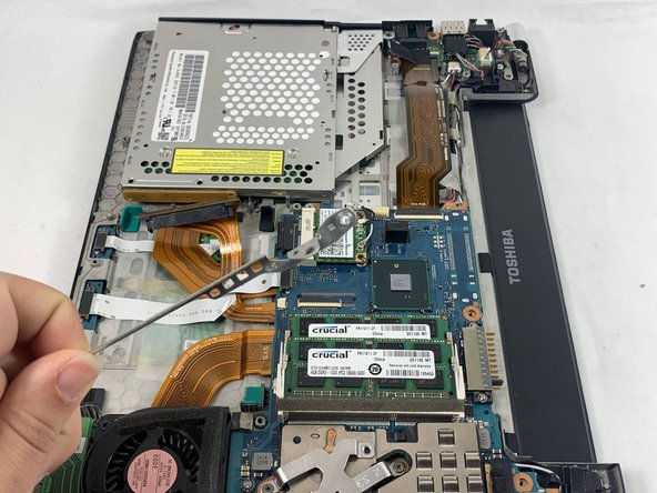

  11. Toshiba Portege R705-P35 DVD Drive Replacement, DVD Drive: crwdns2935265:011crwdnd2935265:01crwdnd2935265:02crwdne2935265:0 Toshiba Portege R705-P35 DVD Drive Replacement, DVD Drive: crwdns2935265:011crwdnd2935265:02crwdnd2935265:02crwdne2935265:0
    • Use an opening tool to detach the hard drive connector from the DVD drive.

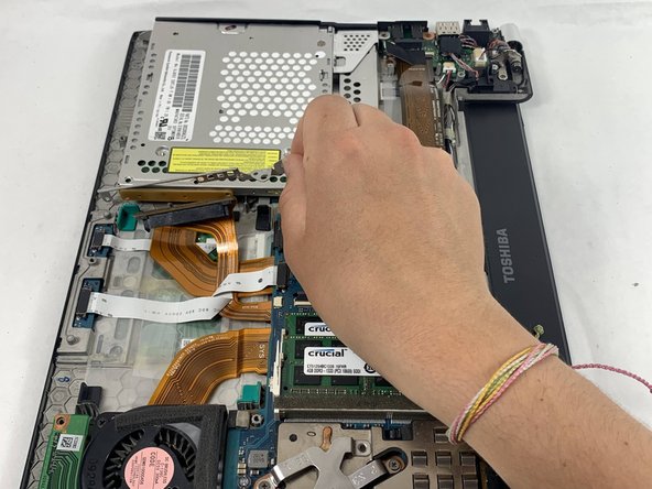

  12. Toshiba Portege R705-P35 DVD Drive Replacement: crwdns2935265:012crwdnd2935265:01crwdnd2935265:03crwdne2935265:0 Toshiba Portege R705-P35 DVD Drive Replacement: crwdns2935265:012crwdnd2935265:02crwdnd2935265:03crwdne2935265:0 Toshiba Portege R705-P35 DVD Drive Replacement: crwdns2935265:012crwdnd2935265:03crwdnd2935265:03crwdne2935265:0
    • Remove the two 4 mm screws using a Phillips #00 screwdriver.
    • Remove the one 3 mm screw using a Phillips #00 screwdriver.
    • Remove the silver bracket that comes loose.

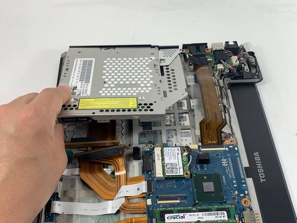

  13. Toshiba Portege R705-P35 DVD Drive Replacement: crwdns2935265:013crwdnd2935265:01crwdnd2935265:03crwdne2935265:0 Toshiba Portege R705-P35 DVD Drive Replacement: crwdns2935265:013crwdnd2935265:02crwdnd2935265:03crwdne2935265:0 Toshiba Portege R705-P35 DVD Drive Replacement: crwdns2935265:013crwdnd2935265:03crwdnd2935265:03crwdne2935265:0
    • Pull on the orange bar with your fingers to detach it from the DVD drive.
    • Pull out and remove the DVD drive from the laptop.
