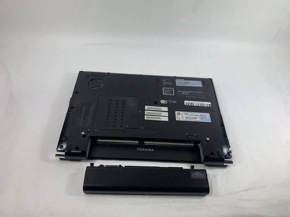

    • Turn off and unplug the laptop.
    • Failure to turn off and unplug the cable could result in electric shock.
    • Place the laptop upside-side-down with the hinges towards you.
  2. Toshiba Portege R705-P35 Back Plate Replacement: crwdns2935265:02crwdnd2935265:01crwdnd2935265:01crwdne2935265:0
    • Use your right hand to move the right switch from the locked position to the unlocked position.
    • Use your left hand to move the left switch from the locked position to the unlocked position.
  3. Toshiba Portege R705-P35 Back Plate Replacement: crwdns2935265:03crwdnd2935265:01crwdnd2935265:02crwdne2935265:0 Toshiba Portege R705-P35 Back Plate Replacement: crwdns2935265:03crwdnd2935265:02crwdnd2935265:02crwdne2935265:0
    • While keeping the left switch unlocked, pull the battery away from the computer with your right hand.

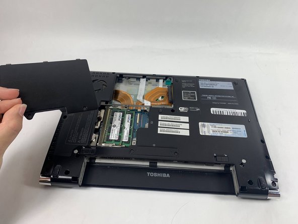

  4. Toshiba Portege R705-P35 Back Plate Replacement, RAM Plate: crwdns2935265:04crwdnd2935265:01crwdnd2935265:03crwdne2935265:0 Toshiba Portege R705-P35 Back Plate Replacement, RAM Plate: crwdns2935265:04crwdnd2935265:02crwdnd2935265:03crwdne2935265:0 Toshiba Portege R705-P35 Back Plate Replacement, RAM Plate: crwdns2935265:04crwdnd2935265:03crwdnd2935265:03crwdne2935265:0
    • Loosen the two captive screws in the plate with a Phillips #00 screwdriver.
    • Remove the plate from the laptop.
