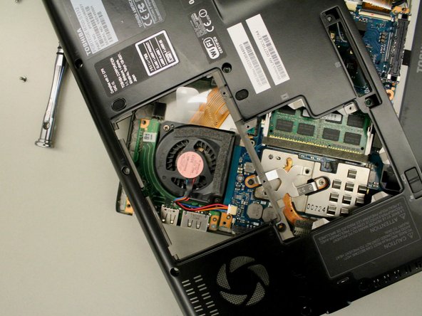

    • Begin by removing 14 70mm screws from the back cover of the laptop using a Phillips #00 Screwdriver. Do not attempt to remove the back cover just yet though.
  5. Toshiba Portege R700-S1312 Fan Replacement: crwdns2935265:05crwdnd2935265:01crwdnd2935265:01crwdne2935265:0
    • Next, using a Phillips #00 Screwdriver unscrew 2 40mm screws from the RAM cover, and remove the RAM cover.
  6. Toshiba Portege R700-S1312 Fan Replacement: crwdns2935265:06crwdnd2935265:01crwdnd2935265:01crwdne2935265:0
    • Next, unscrew 2 40mm screws using a Phillips #00 Screwdriver. The back cover will now be able to be removed with greater ease. Note the previously covered 70mm screw illustrated by a red circle on the image.
  7. Toshiba Portege R700-S1312 Fan Replacement: crwdns2935265:07crwdnd2935265:01crwdnd2935265:02crwdne2935265:0 Toshiba Portege R700-S1312 Fan Replacement: crwdns2935265:07crwdnd2935265:02crwdnd2935265:02crwdne2935265:0
    • The back cover of the laptop can now be removed by gently lifting its edges with your hands. Avoid abrupt removal of the back cover because it is attached internally. Move the cover to the side and the fan will now be visible.

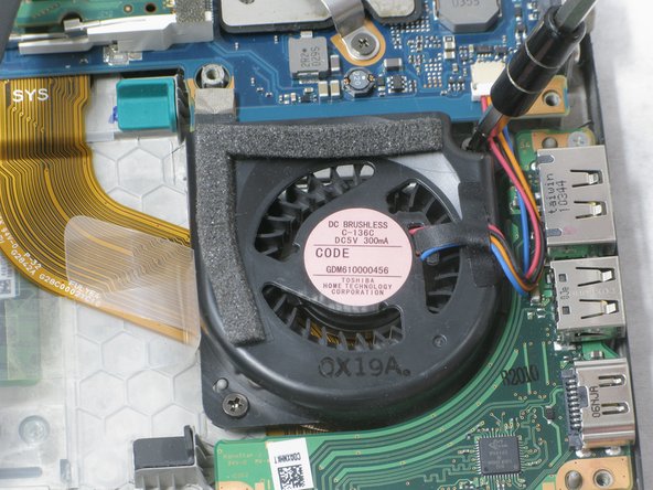

  8. Toshiba Portege R700-S1312 Fan Replacement: crwdns2935265:08crwdnd2935265:01crwdnd2935265:02crwdne2935265:0 Toshiba Portege R700-S1312 Fan Replacement: crwdns2935265:08crwdnd2935265:02crwdnd2935265:02crwdne2935265:0
    • Remove the two 50mm screws holding down the fan using a Phillips #00 screwdriver.
  9. Toshiba Portege R700-S1312 Fan Replacement: crwdns2935265:09crwdnd2935265:01crwdnd2935265:01crwdne2935265:0
    • Disconnect the fan's power cables from the motherboard by gently pulling the white connector towards the fan and away from the motherboard.
  10. Toshiba Portege R700-S1312 Fan Replacement: crwdns2935265:010crwdnd2935265:01crwdnd2935265:01crwdne2935265:0
    • You can now safely remove the fan completely and replace it with your replacement fan.
