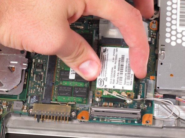

  4. Toshiba Portege R500 Wi-FI Card Replacement: crwdns2935265:04crwdnd2935265:01crwdnd2935265:02crwdne2935265:0 Toshiba Portege R500 Wi-FI Card Replacement: crwdns2935265:04crwdnd2935265:02crwdnd2935265:02crwdne2935265:0
    • Unscrew the two 3.5 mm screws from the Wi-Fi card with the Phillips 00 screwdriver.
    • Pull the Wi-Fi card towards the battery slot to release it.
  5. Toshiba Portege R500 Wi-FI Card Replacement: crwdns2935265:05crwdnd2935265:01crwdnd2935265:01crwdne2935265:0
    • Remove the three wires from the Wi-Fi card by pulling them straight up and off.
    • The Wi-Fi card should now be free of the laptop.
    • When removing the wires be sure to remember which wire came from which port, consider marking them so that you can remember.
