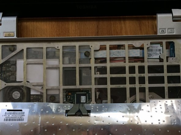

    • After removing the doors and battery, remove the screws securing the lower case.
    • Disconnect the keyboard cable.
  2. Toshiba Portege R500 Keyboard Replacement: crwdns2935265:02crwdnd2935265:01crwdnd2935265:02crwdne2935265:0 Toshiba Portege R500 Keyboard Replacement: crwdns2935265:02crwdnd2935265:02crwdnd2935265:02crwdne2935265:0
    • Disconnect the trackpad cable
  3. Toshiba Portege R500 Keyboard Replacement: crwdns2935265:03crwdnd2935265:01crwdnd2935265:02crwdne2935265:0 Toshiba Portege R500 Keyboard Replacement: crwdns2935265:03crwdnd2935265:02crwdnd2935265:02crwdne2935265:0
    • Heat the keyboard to loosen the adhesive.
    • Pry the keyboard up.
  4. Toshiba Portege R500 Keyboard Replacement: crwdns2935265:04crwdnd2935265:01crwdnd2935265:01crwdne2935265:0
    • Follow the above steps in reverse to install a new keyboard.
