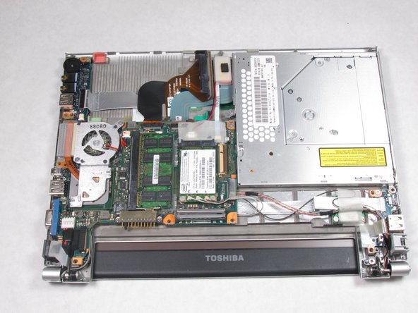

  2. Toshiba Portege R500 Audio/USB Port Replacement, Audio/USB Port: crwdns2935265:02crwdnd2935265:01crwdnd2935265:01crwdne2935265:0
    • Remove the sixteen screws at the locations shown with the Phillips 00 screwdriver.
  3. Toshiba Portege R500 Audio/USB Port Replacement: crwdns2935265:03crwdnd2935265:01crwdnd2935265:02crwdne2935265:0 Toshiba Portege R500 Audio/USB Port Replacement: crwdns2935265:03crwdnd2935265:02crwdnd2935265:02crwdne2935265:0
    • Pull up on the back casing and remove it, revealing the audio/usb port.
  4. Toshiba Portege R500 Audio/USB Port Replacement: crwdns2935265:04crwdnd2935265:01crwdnd2935265:01crwdne2935265:0
    • Remove the single 4 mm screw holding the port in place with the Phillips 00 screwdriver.
  5. Toshiba Portege R500 Audio/USB Port Replacement: crwdns2935265:05crwdnd2935265:01crwdnd2935265:01crwdne2935265:0
    • Use the plastic opening tool to disconnect the port from its power source on the laptop. This will be the wire connector with the white connection.
  6. Toshiba Portege R500 Audio/USB Port Replacement: crwdns2935265:06crwdnd2935265:01crwdnd2935265:01crwdne2935265:0
    • Remove the ribbon cable from the port to free it from the laptop.
    • Be careful when reconnecting the ribbon cable, it can be difficult.
