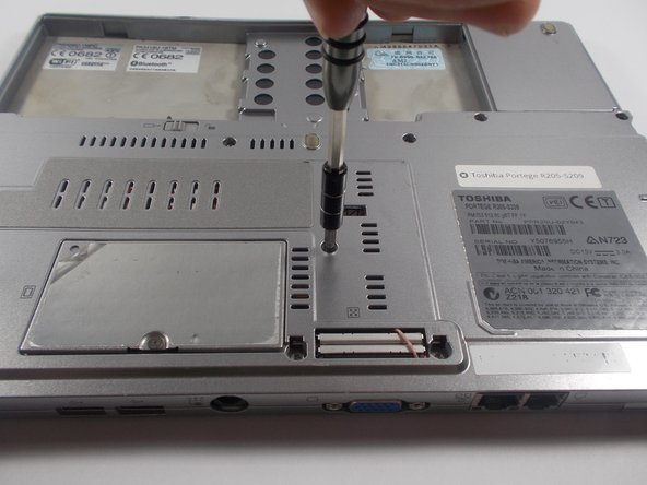

  5. Toshiba Portege R205-S209 Keyboard Replacement, Keyboard: crwdns2935265:05crwdnd2935265:01crwdnd2935265:02crwdne2935265:0 Toshiba Portege R205-S209 Keyboard Replacement, Keyboard: crwdns2935265:05crwdnd2935265:02crwdnd2935265:02crwdne2935265:0
    • Remove the 4mm Phillips head screw in the middle of the laptop with a Phillips head #00 screwdriver.

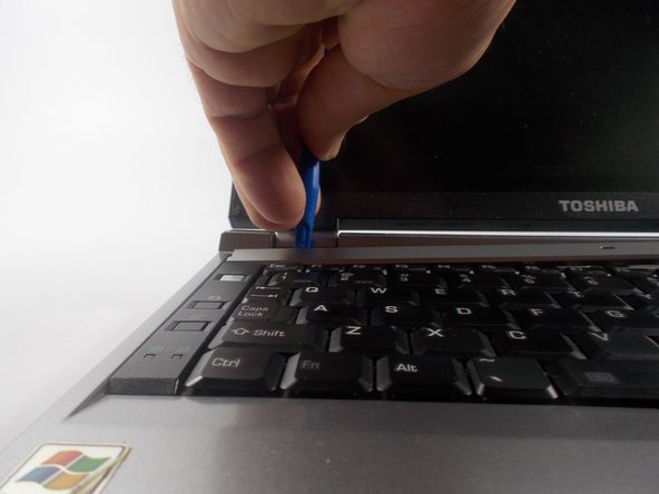

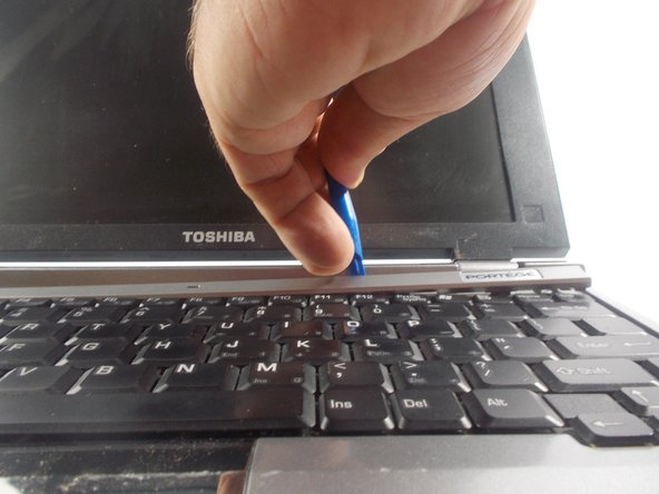

    • Remove the plastic casing above the keyboard with the plastic opening tool. Start at the edges of the plastic casing and move toward the middle.
  8. Toshiba Portege R205-S209 Keyboard Replacement: crwdns2935265:08crwdnd2935265:01crwdnd2935265:01crwdne2935265:0
    • Lift up and remove the plastic casing.

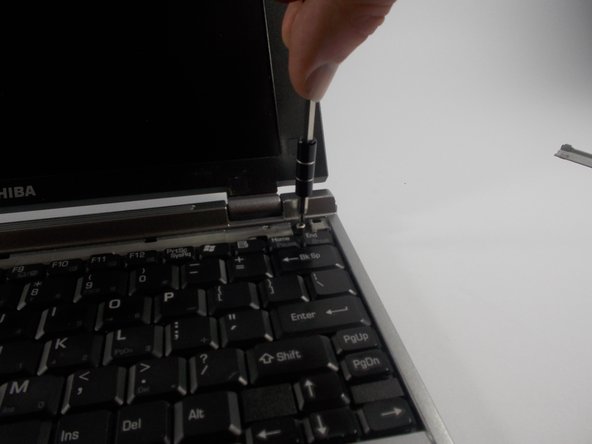

    • Remove the 4mm Phillips head screws at the top of the keyboard at both ends, using the Phillips head #00 screwdriver.

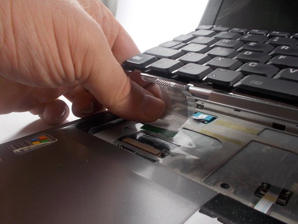

  11. Toshiba Portege R205-S209 Keyboard Replacement: crwdns2935265:011crwdnd2935265:01crwdnd2935265:02crwdne2935265:0 Toshiba Portege R205-S209 Keyboard Replacement: crwdns2935265:011crwdnd2935265:02crwdnd2935265:02crwdne2935265:0
    • Gently pull the ribbon toward the screen until it slides out of the connecting point.
    • Remove keyboard.
