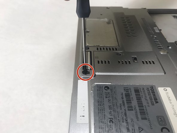

  2. Toshiba Portege R205-S209 Heatsink Fan Replacement: crwdns2935265:02crwdnd2935265:01crwdnd2935265:02crwdne2935265:0 Toshiba Portege R205-S209 Heatsink Fan Replacement: crwdns2935265:02crwdnd2935265:02crwdnd2935265:02crwdne2935265:0
    • Remove the accessory plate by unscrewing the single Phillips #0 screw and lifting up the panel.

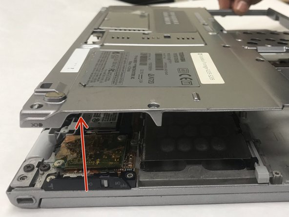

  3. Toshiba Portege R205-S209 Heatsink Fan Replacement: crwdns2935265:03crwdnd2935265:01crwdnd2935265:03crwdne2935265:0 Toshiba Portege R205-S209 Heatsink Fan Replacement: crwdns2935265:03crwdnd2935265:02crwdnd2935265:03crwdne2935265:0 Toshiba Portege R205-S209 Heatsink Fan Replacement: crwdns2935265:03crwdnd2935265:03crwdnd2935265:03crwdne2935265:0
    • Remove the 18 Phillips #0 screws that keep the bottom plate attached to the outer portion of the laptop.

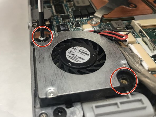

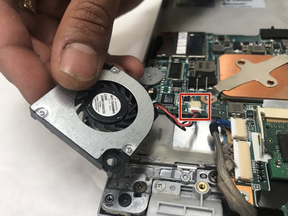

  4. Toshiba Portege R205-S209 Heatsink Fan Replacement: crwdns2935265:04crwdnd2935265:01crwdnd2935265:03crwdne2935265:0 Toshiba Portege R205-S209 Heatsink Fan Replacement: crwdns2935265:04crwdnd2935265:02crwdnd2935265:03crwdne2935265:0 Toshiba Portege R205-S209 Heatsink Fan Replacement: crwdns2935265:04crwdnd2935265:03crwdnd2935265:03crwdne2935265:0
    • Remove the 2 Phillips #0 screws holding the heat sink in place.
    • Detach the heatsink fan from the motherboard by removing the clip that connects them together and pulling away from the laptop horizontally.
