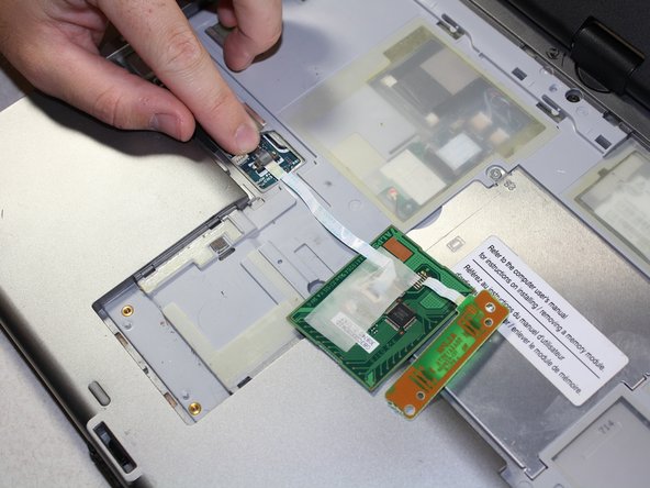

  5. Toshiba Portege M400 Touchpad Replacement, Touchpad: crwdns2935265:05crwdnd2935265:01crwdnd2935265:02crwdne2935265:0 Toshiba Portege M400 Touchpad Replacement, Touchpad: crwdns2935265:05crwdnd2935265:02crwdnd2935265:02crwdne2935265:0
    • Use a plastic opening tool to carefully remove the cover of the touchpad.
    • Remove the one 1/2" inch screw on the backside of the laptop.
  6. Toshiba Portege M400 Touchpad Replacement: crwdns2935265:06crwdnd2935265:01crwdnd2935265:02crwdne2935265:0 Toshiba Portege M400 Touchpad Replacement: crwdns2935265:06crwdnd2935265:02crwdnd2935265:02crwdne2935265:0
    • Gently pull up the touch-pad piece and lay it upside down.
    • The touch-pad will still be connected to the computer.
  7. Toshiba Portege M400 Touchpad Replacement: crwdns2935265:07crwdnd2935265:01crwdnd2935265:02crwdne2935265:0 Toshiba Portege M400 Touchpad Replacement: crwdns2935265:07crwdnd2935265:02crwdnd2935265:02crwdne2935265:0
    • Pull back the tab to disconnect the touchpad to the laptop.
