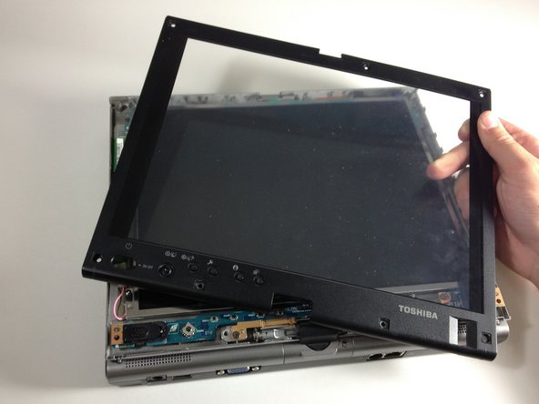

  3. Toshiba Portege M400 Screen Replacement: crwdns2935265:03crwdnd2935265:01crwdnd2935265:02crwdne2935265:0 Toshiba Portege M400 Screen Replacement: crwdns2935265:03crwdnd2935265:02crwdnd2935265:02crwdne2935265:0
    • With a plastic opening tool, prop the plastic panel up to separate it from the rest of the laptop.
    • Slowly pull the plastic panel from the entire laptop.

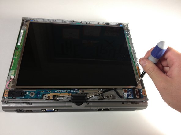

  4. Toshiba Portege M400 Screen Replacement: crwdns2935265:04crwdnd2935265:01crwdnd2935265:02crwdne2935265:0 Toshiba Portege M400 Screen Replacement: crwdns2935265:04crwdnd2935265:02crwdnd2935265:02crwdne2935265:0
    • Remove the four 5 mm screws with a Phillips #1 screwdriver, each located at the four corners of the screen.
  5. Toshiba Portege M400 Screen Replacement: crwdns2935265:05crwdnd2935265:01crwdnd2935265:02crwdne2935265:0 Toshiba Portege M400 Screen Replacement: crwdns2935265:05crwdnd2935265:02crwdnd2935265:02crwdne2935265:0
    • Carefully lift up the screen from the rest of the laptop and let it lean towards you, as it is still attached to cords and other wirings.

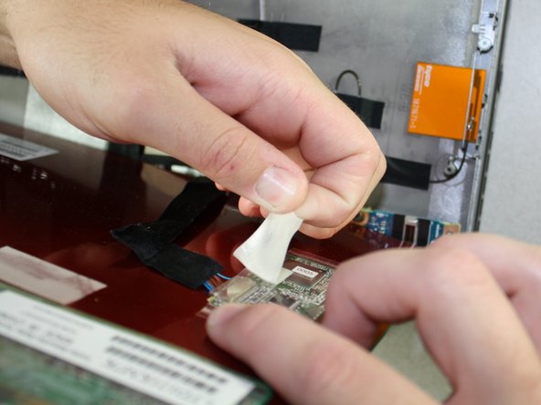

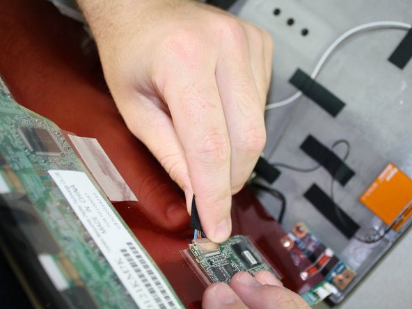

  6. Toshiba Portege M400 Screen Replacement: crwdns2935265:06crwdnd2935265:01crwdnd2935265:02crwdne2935265:0 Toshiba Portege M400 Screen Replacement: crwdns2935265:06crwdnd2935265:02crwdnd2935265:02crwdne2935265:0
    • Note: Some parts need unplugging. Slowly and carefully unplug each of the components.
  7. Toshiba Portege M400 Screen Replacement: crwdns2935265:07crwdnd2935265:01crwdnd2935265:01crwdne2935265:0
    • At this point, the screen should be completely disconnected from the rest of the laptop.
