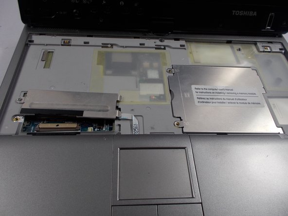

  5. Toshiba Portege M400 Motherboard  Replacement: crwdns2935265:05crwdnd2935265:01crwdnd2935265:02crwdne2935265:0 Toshiba Portege M400 Motherboard  Replacement: crwdns2935265:05crwdnd2935265:02crwdnd2935265:02crwdne2935265:0
    • Use a small phillips screwdriver to remove both metal shields as depicted.

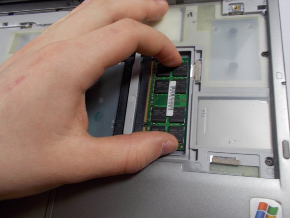

  6. Toshiba Portege M400 Motherboard  Replacement: crwdns2935265:06crwdnd2935265:01crwdnd2935265:02crwdne2935265:0 Toshiba Portege M400 Motherboard  Replacement: crwdns2935265:06crwdnd2935265:02crwdnd2935265:02crwdne2935265:0
    • After removing the second metal covering you will remove the RAM compartment.
    • Simply pull apart the metal fasteners on the side; the RAM should pop out for removal.

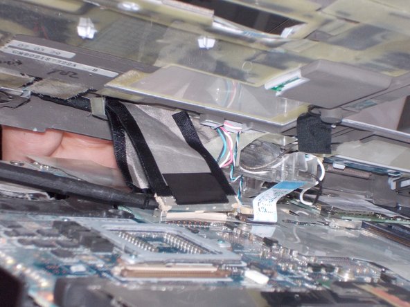

  7. Toshiba Portege M400 Motherboard  Replacement: crwdns2935265:07crwdnd2935265:01crwdnd2935265:03crwdne2935265:0 Toshiba Portege M400 Motherboard  Replacement: crwdns2935265:07crwdnd2935265:02crwdnd2935265:03crwdne2935265:0 Toshiba Portege M400 Motherboard  Replacement: crwdns2935265:07crwdnd2935265:03crwdnd2935265:03crwdne2935265:0
    • Disconnect the wire from the exposed wireless card.
    • Pry open the top of the laptop and gently remove and disconnect the wires as shown.

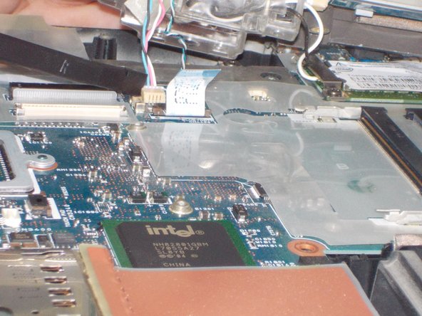

  8. Toshiba Portege M400 Motherboard  Replacement: crwdns2935265:08crwdnd2935265:01crwdnd2935265:02crwdne2935265:0 Toshiba Portege M400 Motherboard  Replacement: crwdns2935265:08crwdnd2935265:02crwdnd2935265:02crwdne2935265:0
    • Remove the screws attaching the motherboard to the plastic housing.
    • Lift off the motherboard. Once it is free of screws and you're done!
