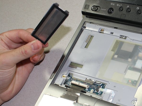

    • Remove the front face plate with a plastic opening tool.
    • Unscrew and remove the two 3.8mm screws labeled B3 with the #1 Phillips screwdriver.

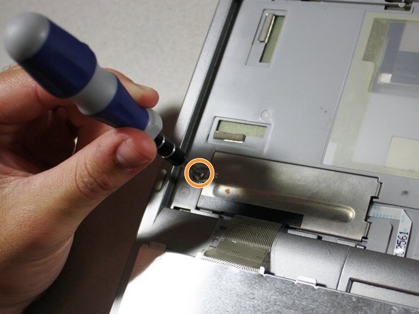

  3. Toshiba Portege M400 Keyboard Replacement: crwdns2935265:03crwdnd2935265:01crwdnd2935265:03crwdne2935265:0 Toshiba Portege M400 Keyboard Replacement: crwdns2935265:03crwdnd2935265:02crwdnd2935265:03crwdne2935265:0 Toshiba Portege M400 Keyboard Replacement: crwdns2935265:03crwdnd2935265:03crwdnd2935265:03crwdne2935265:0
    • Find the white ribbon connector (where the keyboard is still attached to the rest of the laptop).
    • Remove the screw on the metal plate that keeps the ribbon from sliding out.
    • Gently remove the metal plate and set it aside.
  4. Toshiba Portege M400 Keyboard Replacement: crwdns2935265:04crwdnd2935265:01crwdnd2935265:02crwdne2935265:0 Toshiba Portege M400 Keyboard Replacement: crwdns2935265:04crwdnd2935265:02crwdnd2935265:02crwdne2935265:0
    • Dislodge the white ribbon connector from the two clips holding it in place using the plastic opening tools.
    • Pull out the white ribbon connector with your fingers.
