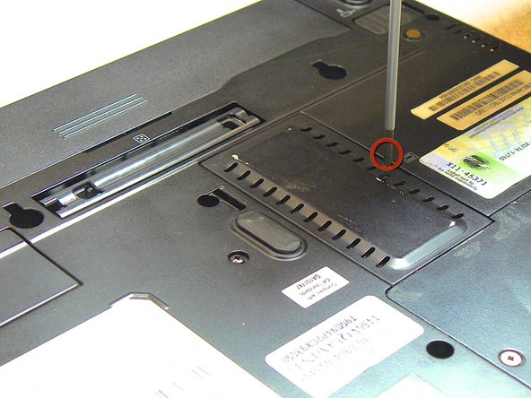

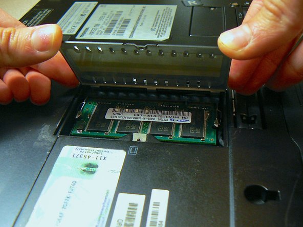

  4. Toshiba Portege M300 RAM Replacement, RAM: crwdns2935265:04crwdnd2935265:01crwdnd2935265:03crwdne2935265:0 Toshiba Portege M300 RAM Replacement, RAM: crwdns2935265:04crwdnd2935265:02crwdnd2935265:03crwdne2935265:0 Toshiba Portege M300 RAM Replacement, RAM: crwdns2935265:04crwdnd2935265:03crwdnd2935265:03crwdne2935265:0
    • Turn the computer over onto the back.
    • Use a Phillips head screwdriver to remove the screw holding the RAM cover in place, and lift the cover.
    • One 4.0 mm coarse thread screw.
  5. Toshiba Portege M300 RAM Replacement: crwdns2935265:05crwdnd2935265:01crwdnd2935265:03crwdne2935265:0 Toshiba Portege M300 RAM Replacement: crwdns2935265:05crwdnd2935265:02crwdnd2935265:03crwdne2935265:0 Toshiba Portege M300 RAM Replacement: crwdns2935265:05crwdnd2935265:03crwdnd2935265:03crwdne2935265:0
    • Use a plastic opening tool to open the silver flaps on either side of the RAM.
    • Once both flaps are released, the RAM should pop up at an angle.
