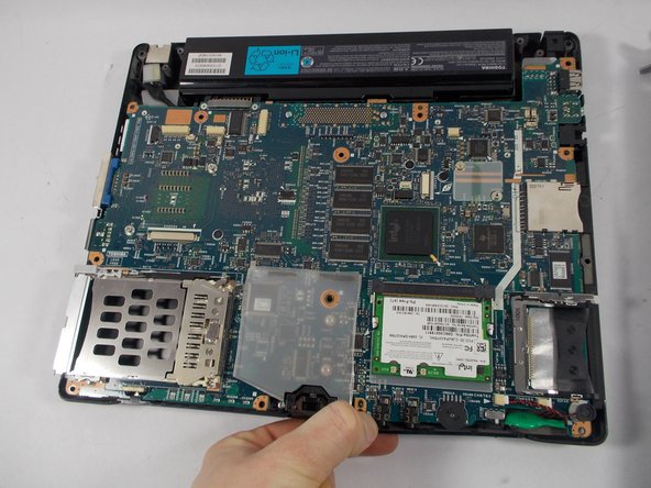

  4. Toshiba Portege M300 Motherboard Replacement: crwdns2935265:04crwdnd2935265:01crwdnd2935265:01crwdne2935265:0
    • Underneath the black protective cover locate the wires that are for the speakers.
    • With one hand holding the black cover up, with free hand carefully pull away the speaker wires, removing them from the laptop’s body.
  5. Toshiba Portege M300 Motherboard Replacement: crwdns2935265:05crwdnd2935265:01crwdnd2935265:01crwdne2935265:0
    • Close laptop.
    • Grip the left and right sides of the top side of the laptop. (Silver portion).
    • Lift gently with both hands upward.
    • Top portion should disengage from the bottom half of the laptop. (Black portion).

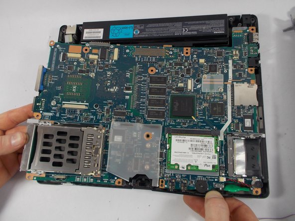

  6. Toshiba Portege M300 Motherboard Replacement: crwdns2935265:06crwdnd2935265:01crwdnd2935265:03crwdne2935265:0 Toshiba Portege M300 Motherboard Replacement: crwdns2935265:06crwdnd2935265:02crwdnd2935265:03crwdne2935265:0 Toshiba Portege M300 Motherboard Replacement: crwdns2935265:06crwdnd2935265:03crwdnd2935265:03crwdne2935265:0
    • With fingers scale the sides of the motherboard and pull back tabs that are holding the motherboard in place to the laptop.
    • Once all tabs are pulled back the motherboard should easily be able to be removed from the bottom half of the laptop.
